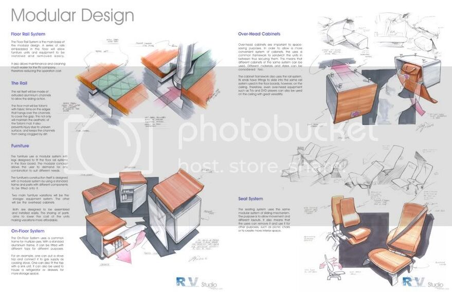

My proposal:
Modular unit for rental. Why?
No need for ownership, less responsibility.
Modular design means the interior can be custom-arranged. It works for everyone and cheaper for the rental company to operate.
Below are the pages originally in 2X letter size layouts. The pages are supposed to be split in the middle for portfolio.
The customer can make a reservation online, and just drag and drop their desired furniture and equipment depending on the length of their holidays and their needs.
Flat floor plan allows more freedom for combinations as well as spcace.
The construction of the furniture and equipment is modular as well. You have a main frame and everything else is interchangable. Eg. A main frame with a stove top becomes a cooking station. A mainframe with a sink becomes the sink.
The units slide into place on a rail system that is embedded on the floor and the ceiling. So they can be arranged relatively and conveniently.

dude it looks sweet, i wish i could read the stuff though. your sketches are very readable, and it looks like you did your homework on it, although the hot tub on the roof on a glass? cabin seems very iffy. great job, homie!
