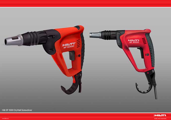

here’s another from product design forums: all photoshop rendering. by Zander
http://www.productdesignforums.com/index.php?showtopic=3102
Just to use as a bench mark as far as proportion and form development. Where are you on the project now?
I started to cut foam to make model. I ll try to work on design of it. Do you think its important to have so many details on the drill? I would like to keep it simple shaped. as my other designs.
The rendering is perfect. At first sight I thought its render of 3d model. I prefer 3D models, becouse I believe, that I will sometime use it for CNC machines.
