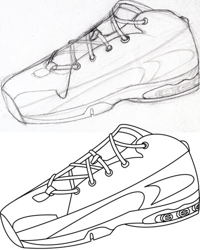

Here is an another shoe I’m working on. It still takes me long to make a linework in Illustrator, all the little sections are closed loops so I can easily color them later. But I had to overlap them rightly that was kinda tricky. This time I’ll try to add a texture.

yeah illustrator can be particularly tricky with fills for perspective sometimes. your sketch is still a lil’ bit off, here is where you might take take a picture of a shoe in perspective, and drawthrough it to so you will recognize “proper” proportions and try to come close to that in your sketches…

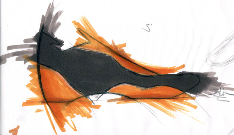

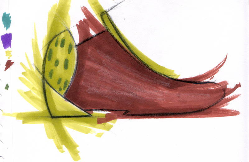

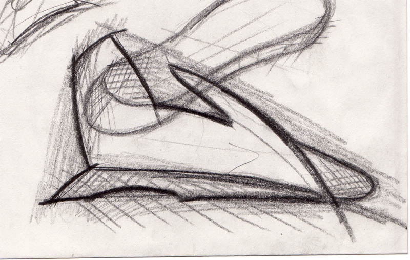

Here are some of my better shoe designs, all rendered by hand,
have had a go in photoshop, but so far nothinkg looks that great…
Three more to follow in the next post…
I think my designs are ak but perhaps a bit weird and whacky, does anyone know how to add better highlights?
How is the perspective?
What soet of paer do people use? I know its down to personal prefrence, but i don’t think i can seem to find whats best?..

hey Felix,
What I would do first is go get yourself some really smooth paper… maybe some bond layout paper, canson marker paper, or even some smooth copy paper… Just to try it out, because the rough toothed paper that you are using is kinda hard to work with sometimes… especially with the drawing style that you are trying to achieve…
Next, I would put down the markers for a little bit and work on your linework… try to get some smooth lines working for you along with the correct perspective. Look at pictures of shoes and try to work out the proportions by comparing the shoes to reference points. Also remember to draw through your shoes… once you have that nailed down I would try to shade the whole shoe as a one form and begin to really feel whats going on there…
Only once you have done all that I would recommend going back to the markers and trying to really render a shoe. And sometimes with markers, less is more… just try to hint at the forms and colors and remember where your light is going to be hottest then you can leave a space white. And just try to work on the fundamentals of really filling in the shoe and describing the form, sometimes all the extra marker strokes outside the line drawing really can take away from what you are trying to communicate and sometimes just becomes messy… Maybe you would like to try pen as well?

Your lines are too thick and rough,proportions totaly off.
I’m gonna put what you should try to do,for practice,practice your artwork by hand,like the pictures.
totaly hand working:
