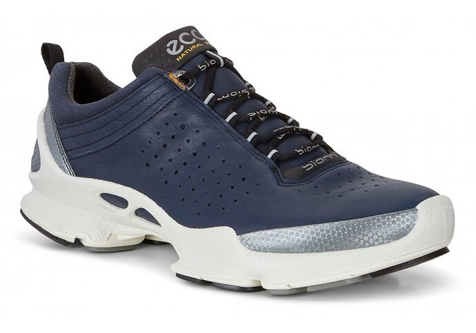

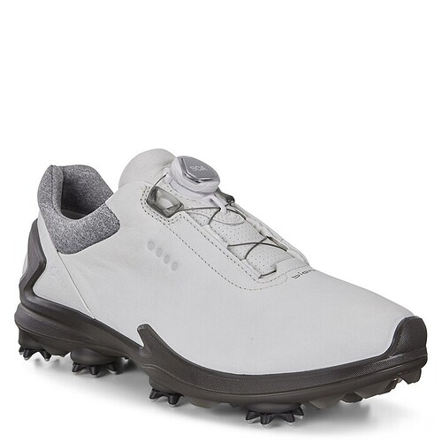

You could look into Ecco, direct injection has been their bread and butter for years. Their Biom series is the most notable I believe
