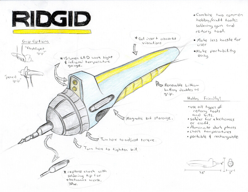

I just finished my first year at design school and I’d like to take the summer to improve drastically on my sketching ability.
I look forward to your feedback. No sense in building on bad habits!
Thank you,
Adam
This is a cordless rotary tool idea I’m working on.

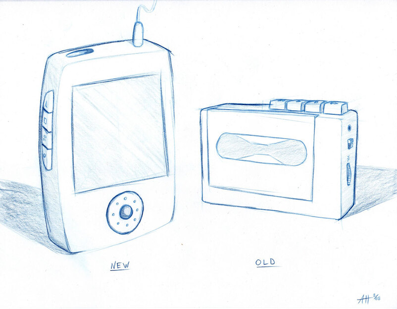

These are some more speaker ideas further developing my Helios project.
Good idea to post your work. I t will be a great way to track your progress as well as get feedback. The first thing I would say is to loosen up. Try to put down lines with more conviction, and more abstractly. Explore on the paper more…

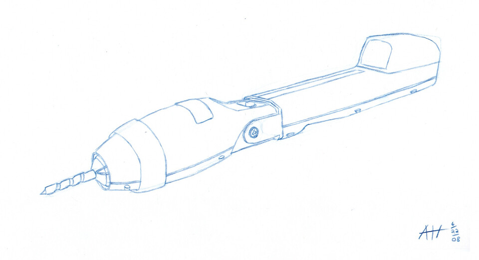

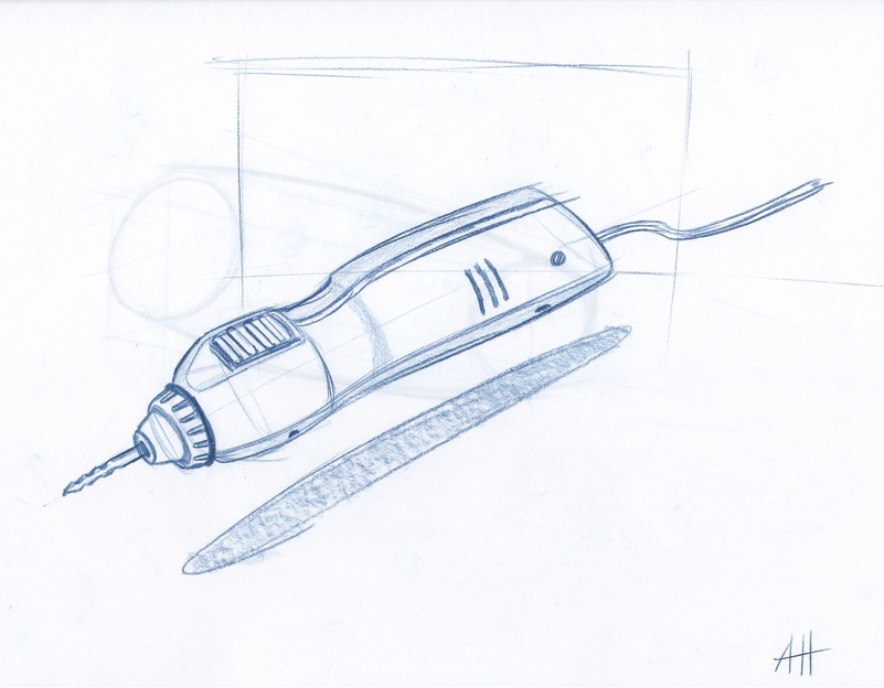

Latest sketch. Tried to free myself up and the idea came down a lot quicker than last time. Still not as “flowey” as I’d like, but it will take some time.
Comments welcome!
Thanks.
good step! Just keep taking it one step at a time. I’d recommend coming back with fresh eyes on this tomorrow and throwing dow an overlay. I bet you will work the problem over differently.
I agree. That’s definitly the plan. I made that off of an underlay and I can already see many perspective issues in both.

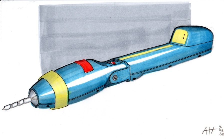

marker practice. overlay of a previous rotary tool design i did.

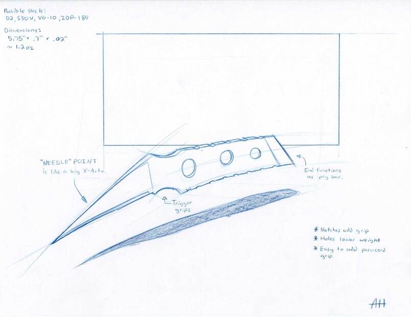

I’m headed back to school in a few days. Here are two of the most recent. I’ve come a long way this summer but I’ve still got a lot more skill to develop before I’ll be happy.
Feedback welcome! Thanks for your help.
Getting looser which is good. Watch the perspective on the hand drill. The on/off switch seems to be in a slightly different perspective that the butt of the handle.
The knife sketch is nice and loose, some heavier line weights and thick to thin marks would make this pop more.
