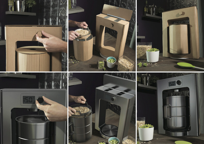

Like with sketching though it all comes down to practice and knowing what materials are appropriate for the job. Cardboard is the simplest medium to prototype in and I used a lot of Jude Pullen’s tips and tricks even before I discovered who he was. At my last job we had a laser cutter and I could deconstruct a product, make the parts in to a net, cut it out and assemble it all together with hot glue, job done.
In regards to using CAD then again practice but it can be a little more difficult to master. I taught myself the basics of Solidworks by watching YouTube videos that built something as they demonstrated the tools. I’d then build it myself step by step. When it came to using it at work I knew where everything was and just practiced until I got what I wanted and even watched some videos in the office when I needed to do something I didn’t know.
I’ve attached some pictures of my models we used for photographs/renders to show you just how far cardboard and hot glue can take you.

They are brilliant. You need to show more and process.
Thanks. These were just pictures to demonstrate to the OP where you can take cardboard - don’t worry my projects show plenty of process using the skills applied here :wink:

@Sketchgrad: Those are beast. Makes me want to do some of that more.
Thanks a lot! I know I keep saying it but having access to a laser cutter was a god send, I was sad to leave knowing my next place wouldn’t have the same facilities. Cutting all of that out by hand would take me at least half a day or more, where as this way laying out the Illustrator file was an hour at the most then it was a push of a button, some hot glue and there we go.

@sketch_grad: Those prototypes are inspiring, very nicely constructed, thanks for sharing them. Did you use a laser cutter to develop a net for those cubic forms? I usually spend money on polystyrene foam, now I can just go to the back of a shop and get some free cardboard lol.

Those were made to represent the final design and weren’t process models. What I did was take the 3D file in Solidworks and lay them out as a tech drawing where I had the profile views I needed. I exported it as an Illustrator file and cleaned up the line work and added pieces so that I could construct a net from them for cutting. I would still develop your foam skills and its a great way to quickly experiment with form for smaller products but as you can see cardboard can also be used to achieve great results.

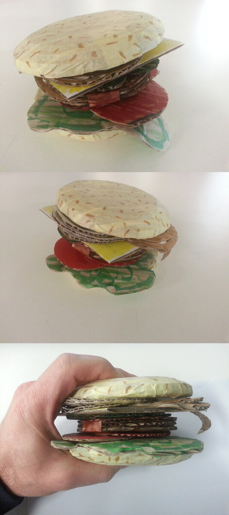

You inspired me. I’m doing some fast food packaging and needed a quick 1:1 hamburger prop, so I made one out of cardboard:
