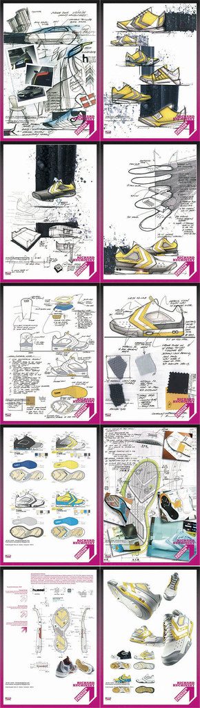

I’ve just posted some new content on a new work-in-progress portfolio site.
under Concept Development, I’ve got quite a few images from the design process (sketches) and development (technical drawings, etc.) from a typical footwear project, you might find interesting.
http://rkuchinsky.blogspot.com/
Click the Read More link below the first image for the complete set of pics. More text on the way soon, too.
[edt] heres the images. larger ones on my site. R
cheers,
Richard
phenomenal.
I love it, really nice mix of sketching, photos. really inspires me.
