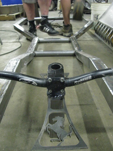

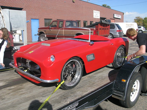

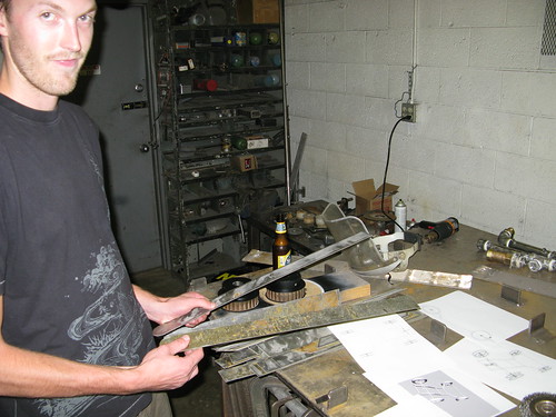

What we came up with was a completely custom chassis. This chassis was going to be 100% boxed and completely hand fabricated. Why not? We have the tools and we should be able to handle it, so we sent off a bunch of drawings to the WaterJet one of our team members has access too.

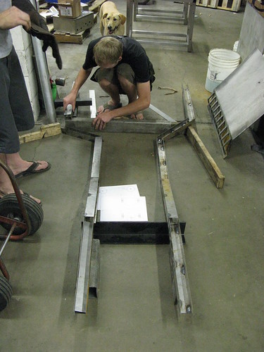

We got our chassis back from the waterjet. it was stacked about 3 inches tall and was about 3 ft long.
The chassis went together fairly quickly.

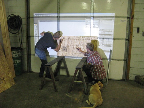

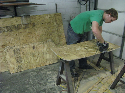

We started working on our Body at this point. Our first step was to create a rib structure. First the body was modeled in Rhino then sectioned into a series of Ribs, each rib was 7.5 inches apart. We then projected the ribs onto a sheet of OSB.
With the rib structure complete we started skinning and carving. We used regular cardboard for the skinning and pink insulation foam for the curvy sections. Each foam section was carved down to create the form.
We then added a front foam section and a rear foam section in order to carve out the front and back of the car.
Once we carved out the front and back and added a hood scoop our car had gotten to this stage.

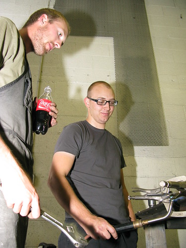

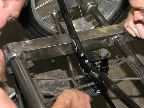

We added steering knuckles, rear axles and our steertube.
In order to make sure everything was straight and allow us to get a good caster angle we bolted both steering knuckles together and tacked them when we got our 6 degrees of caster.
We then made steering linkages, bent our knuckles and bolted everything up.

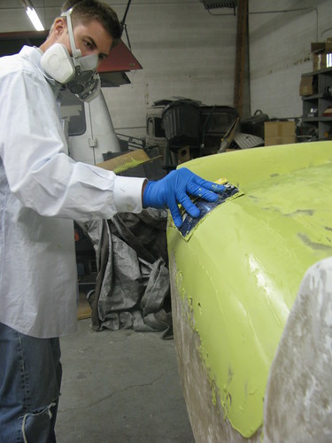

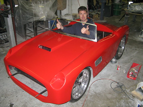

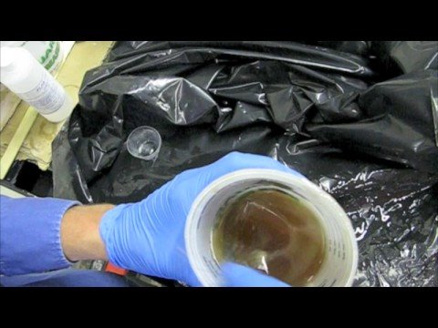

Time to get back to the body, Fiberglass was next. None of us had done fiberglass before so it was a new experience for all of us.
We prepped the chassis for paint while we started working on the body work on the body.

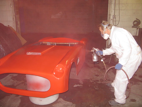

Our body was coming along and we were now ready to start working on the final prep.
We then got our chassis painted and assembled.
and after some final body work on the chassis and some wheel well cutting it was primered.
Then wet sanded…
and painted.
At this point we installed all the details. Trim, bumpers, windshield rearview mirror logos and body mounts.
We ran the car backwards to replicate the final movie scene and installed a rear window in the car, we covered it with perforated vinyl to keep the secrets.
Then we installed headlights… and the car was done!
