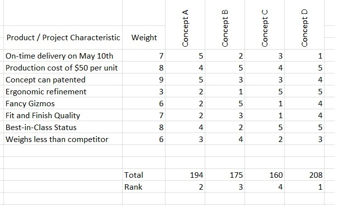

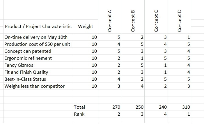

How about creating a decision matrix?
Pretty much create a version of the standard Pugh decision matrix and have your client assign weights to each aspect of the product or the project deliverables, including cost targets and time for delivery. Plug their numbers into your rankings of each concept and use the outputs to show the client what path they should be taking if they want to hit the target. Even if they throw an equal weight on each category, the differences between the feasibility of concepts should be pretty apparent.
