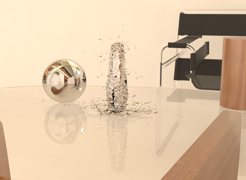

scan was of this stapler

The results from the stapler image look to me like your camera settings are not correct. This scattering of polygons occurs when the laser bounces off the backdrop back to the camera. You will need to lower your exposure and brightness settings. I found best results in my office at night when sunlight does not come in through the blinds behind my setup.
Download the second file on the page to see what your laser should look like when sweeping it over the object. http://www.david-laserscanner.com/?section=Downloads
