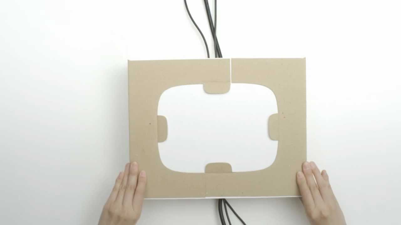

Back on to topic if we as designers are to be ‘green’ then there are steps we can take that aren’t too in your face. Here is an example from Seymourpowell showing how packaging they designed for a product can be turned in to cable management:

Nice video iamdave, the seymourpowell concept is elegant. Just as good design is invisible, perhaps ‘green’ design should be too.
