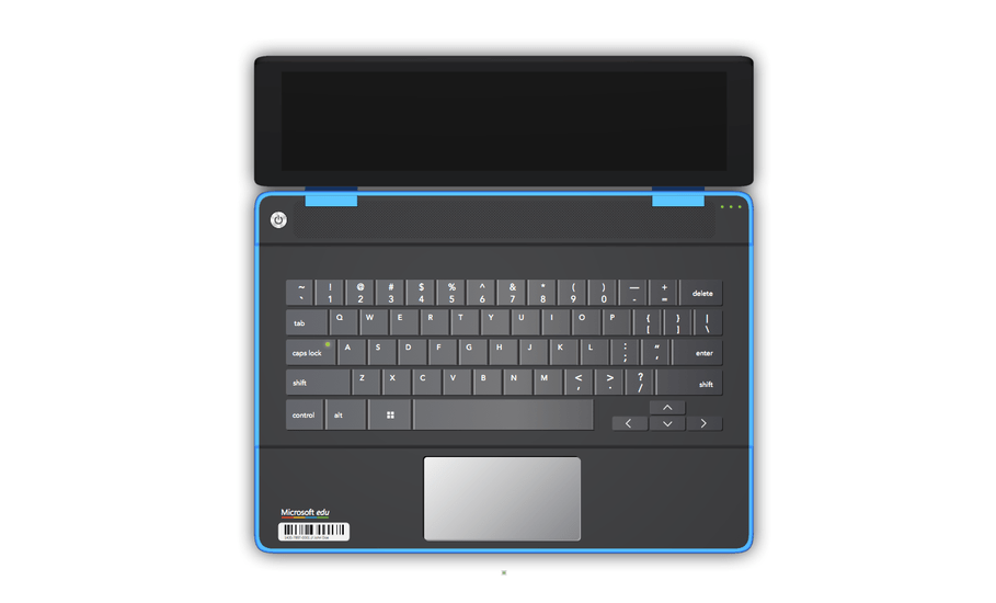

New Keyboard/Interior Layout
Hey hey, there you go. It feels like your now.
Any way to integrate the upc in a more elegant way?
What about the touch pad?
The power button seems out of place now.
can you make the speaker perf go all the way to the edges and put the LEDs underneath and float the power key within it?
The UPC is a cataloguing tool for the school to use. They put the stickers on anyways, so why not designate a place for them. That being said, I realized inside of the computer wasn’t the best place for it. (imagine scanning 200 codes. Open>scan>close…) So I’m gunna move that to the bottom by the regulatory stuff.
Some revisions… I’m still not totally happy with the power button. And the LEDs stil feel a bit cramped. So I’ll see if I can’t figure that out…
It is definitely getting there Dan. The power button stands out as not only round but also metal. What is the thought behiong making it metal?

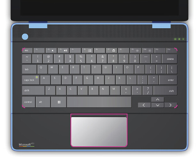

On the touch pad, one thing that always made the classic Braun calculators stand out to me as very refined is that if you look closely, the rads at the top do not match the rads at the bottom. The rads at the top are very sharp and respond to the corners of the small LCD screen that are adjacent, while the rads at the bottom are much larger, responding to the perfectly circular keys that are adjacent. These kinds of small nods to intent and consideration are what seperate something that is merely minimal from something that is beautifully minimal.
I think you could consider something like that on the touch pad since the top line of it is next to what looks like a small step, and the bottom could relate to the radii on the bottom corners of the outer form. Why not go a step further and make the top line completely abut with the step above it?
You might consider a similar detail on the outer keys of your keypad to unify the design.

I think this is a good spot for the keyboard layout. The only thing still bugging me is the power button…
much cleaner. Good work. What about something that plays off the hinge for the power button?
that just might work! I think i’ll do something similar when I cad this all up, though maybe on the right side, by the power indicator icons. Placing the button by the lights it might affect seems to make sense to me.

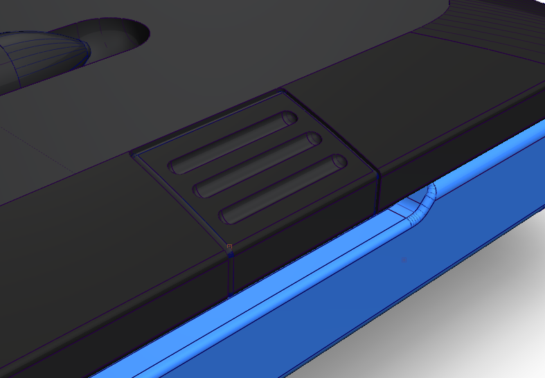

After some time in CAD I finished up the main build

Couple more detail shots of the jump drive and bottom
