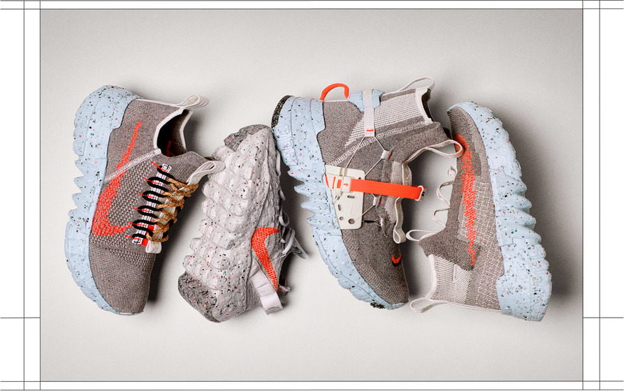

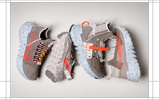

I haven’t worked in situations that are as high temperature or high pressure as something like that Nike plate, but I’ve worked on a ton of footwear outsoles that utilize regrind. Sometimes it was for the distinct visual “fleck,” but often it was a way to make use of at least some of the factory-rejected outsoles that occur naturally during production and would otherwise just get thrown in the trash. In that scenario adding regrind is unfortunately making the rubber substantially less durable, not more, and we would have to be careful how much we added so as not to compromise the performance of the outsoles.
The issue is that the regrind rubber has already been cured, and depending on your rubber type and moulding temperature and/or pressure it may or may not revert back to it’s pre-cured state during a second moulding. If it doesn’t, the regrind rubber won’t fully bond with the newly cured rubber, remaining instead as “floating” chunks throughout the product that separate from the rest of the rubber pretty easily.
A good visual example of this is the Nike Space Hippie line, which liberally uses reground rubber and EVA in its outsoles and midsoles. They can get away with it there because it’s not a performance product, but just running your finger along those midsoles will cause numerous flecks of regrind to fall out almost immediately.
