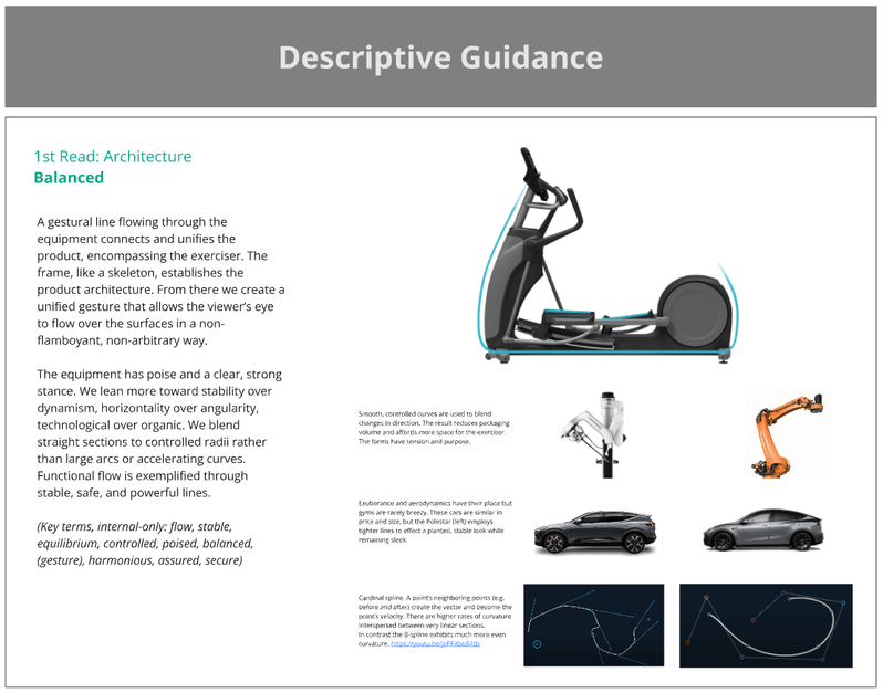

I’ve used ours for onboarding and as a hazy rubric for design ideation, sometimes for directing the right way to do a feature or detail. One ask which I’ve mostly ignored is making the document robust enough to be sent to an overseas manufacturer who throws ID and engineering in for free, so that we can “scale”.
Here’s a page from our basic doc. We eventually made it into a standalone website.
