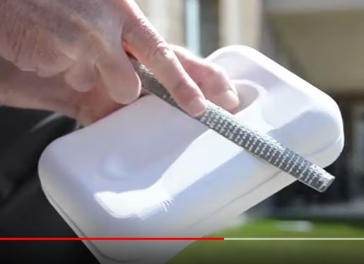

I was watching a promotional video yesterday and the designer in it talked about making a cornstarch model. I think I’ve found some recipes via google, but I was wondering if anyone here has some tips to working with it?

What I found was a recipe for white glue and cornstarch with a little vegetable oil. Supposedly it makes a clay that air dries. The reason I ask for some designer tips is some of the recipes say that it shrinks quite a bit while drying and can crack. Should I paste it over a foam block or make a brick of this stuff? Also, what tools are best to form it? This guy is using a coarse file. Any other recommendations?

there were a bunch of 3d printers in late 90s early 00s that used cornstarch as a the primary medium.
maybe there are still some out there?
Weren’t the zcorp printers cornstarch and resin?
MD is right - ZCorps are pretty much cornstarch and cured with a low viscosity “super glue”
that model looks very much like a Zcorp model - while fragile, you can do some great shaping before they are cured…
you can also impregnate them with resin post to really harden them… still fragile but I have a couple of zcorp prints from 15 years ago here
Those things can turn to bricks! I love Zcorp for resolution and speed.
Owning a Zcorp was just short of hell. The Z-axis kept getting munged up - combine powder and lubricant, no surprise - and with moderate use we had the tech out at least quarterly to replace parts. Utterly impossible to keep clean and the super-glue curing was unpleasant. The whole model would get hot as the glue kicked off. Its a relic of 3D printing in the early 00’s that I am glad is gone. We sold our machine for like 10% of its original cost.
I loved the Z corp for quick aesthetic models. Unfortunately, the manager that had bought it wanted functional models, which it just doesn’t do. I had a big bin of super glue to dip my models. Worked great. As for maintenance, it wasn’t bad. However, as a $30+ industrial machine, it required the fiddling of a hobbyist machine to get it right.

Last, the video shows the designer carving the part. In my experience, I try to do a sketch model and carve that. 3D print off of CAD that I think is final. Maybe just sand the final model to get a better finish.
