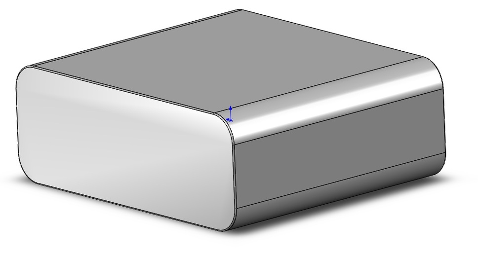

What is the best way to create a concrete mold for this? My first idea was to make an simple inner and outside mold made of wood (with the inner part a bit lower so it can close the back). But I do not know if the shrinkage of the concrete will be a problem? Can I get it out (will it stay intact) without destroying the inner mold? I need to make a serie of 2. The dimensions are roughly 400150400 mm with a thickness of 10 mm.

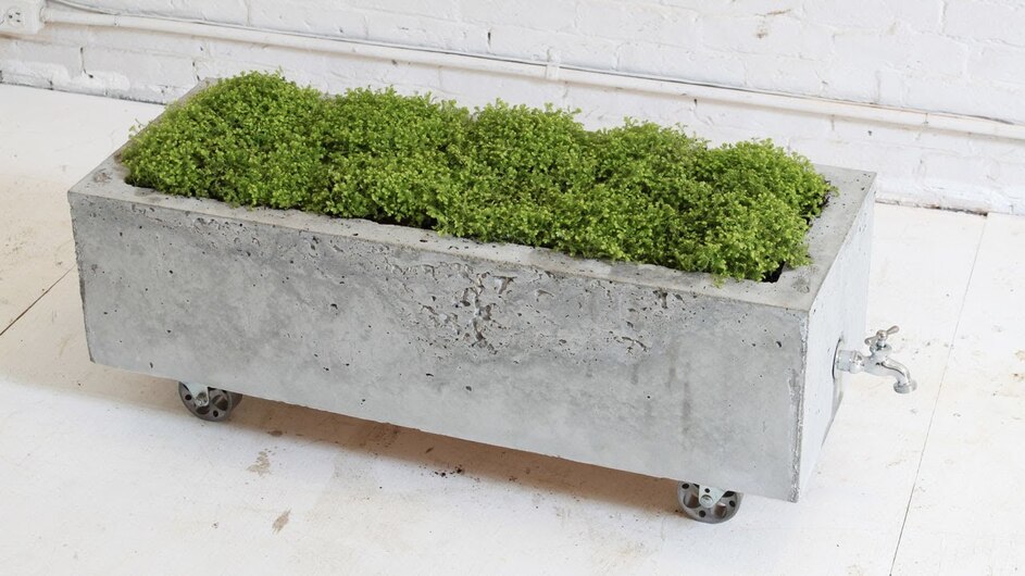

I think if you watch this video, you could take away a lot of info of how they manage to get their concrete furniture really thin and how they mold it. But yea, the 10mm thickness sounds like that is going to be really tough to accomplish, even the furniture in the video is really thin but it still looks thinker than 10mm.
One of the suggested videos from the last one posted had a link to Homemade Modern
http://homemade-modern.com/
He’s got several links to concrete project videos, here is one that is pretty relevant to your problem, the key difference would be that you are probably aiming for multiples off one mold.

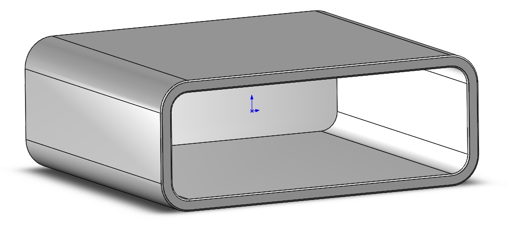

Wow, thanks everyone for the replies! :slight_smile: I attached a rough planning on how I want to make the concrete mold with the help from tips here.
I have a few questions regarding the planning:
  • I see that 10 mm is going to be hard. Is 20 mm going to be enough (without reinforcement)? Can you guys give a rough estimation what the minimum is with and without reinforcements?
  • Do I need mold release with this setup?
  • I guess I do not need draft angle in this setup? Or do I need a small one for the vertical movement (orientation taken from the picture) of the mold of the outer part (or make those parts screw-able)?
  • Any tips on how to make perfect fillets on the insulation foam?
  • Do I need to watch out when buying for a specific concrete mix?
Thanks for all the help!
On the inside mold. Do you have access to a router? You could always just use the correct sized round over bit and make the inside that way.
Just so you get the lingo correct,
Outside mold = cavity
Inside mold = core
Hard to say about the thickness and reinforcement. You may have to have to do it a couple of times to find out. I would worry about the 400mm span cracking in the middle because concrete does not hold under tension. the 150mm walls are under compression, concrete’s strength.
I would use mold release. Freeman Supply has basically what is a vaseline in a spray can. Should work well.
You probably can skip draft. I would just screw and unscrew the cavity for it to release. If you can, hollow out the core made from insulation. It will make it easier to destroy.
A router should make a good fillet. Use the pink or blue insulation foam as it is denser than the white.
Any big box home center should a mix specific for making concrete counter tops. I’d try that one.
