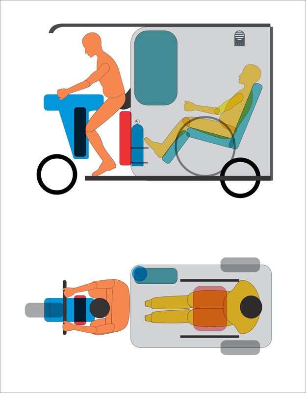

I am currently working on my thesis project, for developing a two wheeler based medical emergency vehicle. The vehicle aims at easy maneuverability in traffic and in narrow spaces(like narrow lanes etc.). My idea is how about an extra wheel to a two wheeler and making it more stable and fast on road. (max speed 50-60kmph).
I would like like your views and insights about how a fully stabilized and comfortable ambulance be developed. The key points I need to take care are Protection(from weather/ accidents etc), safety (dynamism of vehicle/ stability) and speed (have to reach hospital in golden hour).

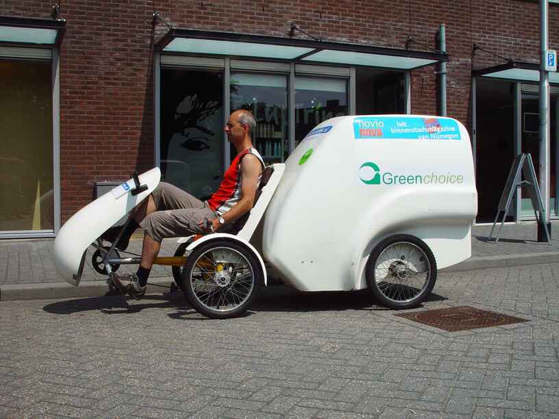

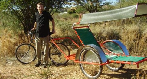

Some inspiration:
[vimeo]http://vimeo.com/49149411[/vimeo]
via: http://zambikes.org/

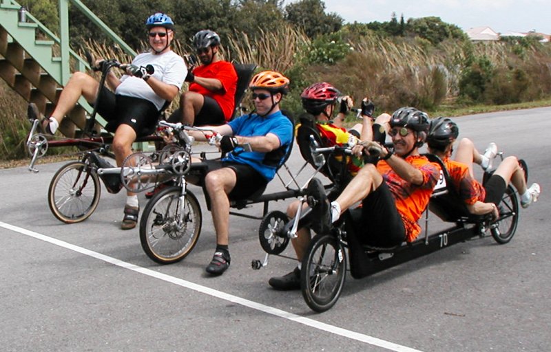

Two wheels in the front and one in the back would be a much safer layout.
I was coming here just to say exactly that!
I think you are proceeding with a very naive concept of what an ambulance is. Unless what you intend to do is simply transport a stable wheelchair bound patient to a hospital you need to consider what equipment is needed in an ambulance before you can design one.
Start here > Equipment for Ambulances
Are you considering the needs of neonate infants, eighty-five year old men, pregnant women, pre-school children, burn victims, patients with broken limbs possibly requiring oxygen and fluid hydration. … . . the list is almost endless. Where will all of this equipment and medicines be stored, some require refrigeration.
The WWII side car ambulance was an answer to a basic question … how to get a patient to medical care. The modern concept of an ambulance is to stabilize the patient on the way to a hospital, thereby extending that “golden hour.”
Assuming for the moment that someone called for your human-powered ambulance how long will it take to get to the patient, and then get to a hospital; obviously we don’t know the distances involved, or the terrain (dirt/gravel roads, etc). Is the “operator” also the Emergency Medical Technician? If so, who cares for the patient during the trip to the hospital? If not, you now have one person “powering” two.
Just some thoughts. It’s an interesting idea, but you’re going to need to spend some time on what it is you are trying to accomplish.

Seems like a good idea and yeah I think it will need that extra wheel.
I was involved in a few tests with a 3 wheeled vehicle mockup with 1 wheel in the front, for something akin to a bike taxi, and it can be surprisingly stable! I could take U-turns at about 10-15mph without any problem. It all depends on the distribution of weight, in this case probably mostly the driver+passenger and then there’s the liquids or batteries if it’s electric and the frame.
In your current configuration it looks like a problem if there would be one wheel in the front, and there’s only the driver in the vehicle.
The best thing is to analyse all the parameters involved, explore a few alternatives and build full scale mockups out of wood, PVC pipe etc., and simulate the weight distribution with whatever you have available. Also thoroughly test getting in and out of the vehicle as well as comfort issues.

I don’t know much about the issues involved of course, but if I look at your packaging drawing it just looks very boxy and high, and the passenger can not lay down.

The design process is still going on, where I am working on the form of the vehicle. The package drawing which I have shared is just for overall idea of the project. As the project stands some right issues, I am not able to share the final design.
