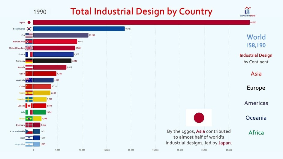

China's dominance of Industrial Design

I would very much like to know where the data came from to create this info-graphic. Raw data is very different from aggregated data.
a quick google search shows similar results from several no-name sites. but it looks like design patent applications not granted patents.
according to another site: “Germany placed number one in international industrial design applications in 2020, obtaining 3,666. The U. 2,211”
(but I’ve never heard of them either https://www.icsid.org/category/industrial-design/ )
The youtube video cites just “World Intellectual Property Organization” and they have some of their stats available here, searchable under a few different metrics, but measured by the ‘Hague System’ which is this I guess: Hague – The International Design System
WIPO IP Statistics Data Center
I didn’t look in depth enough to ‘get it’ but you can see where they pulled the numbers if you look there.
