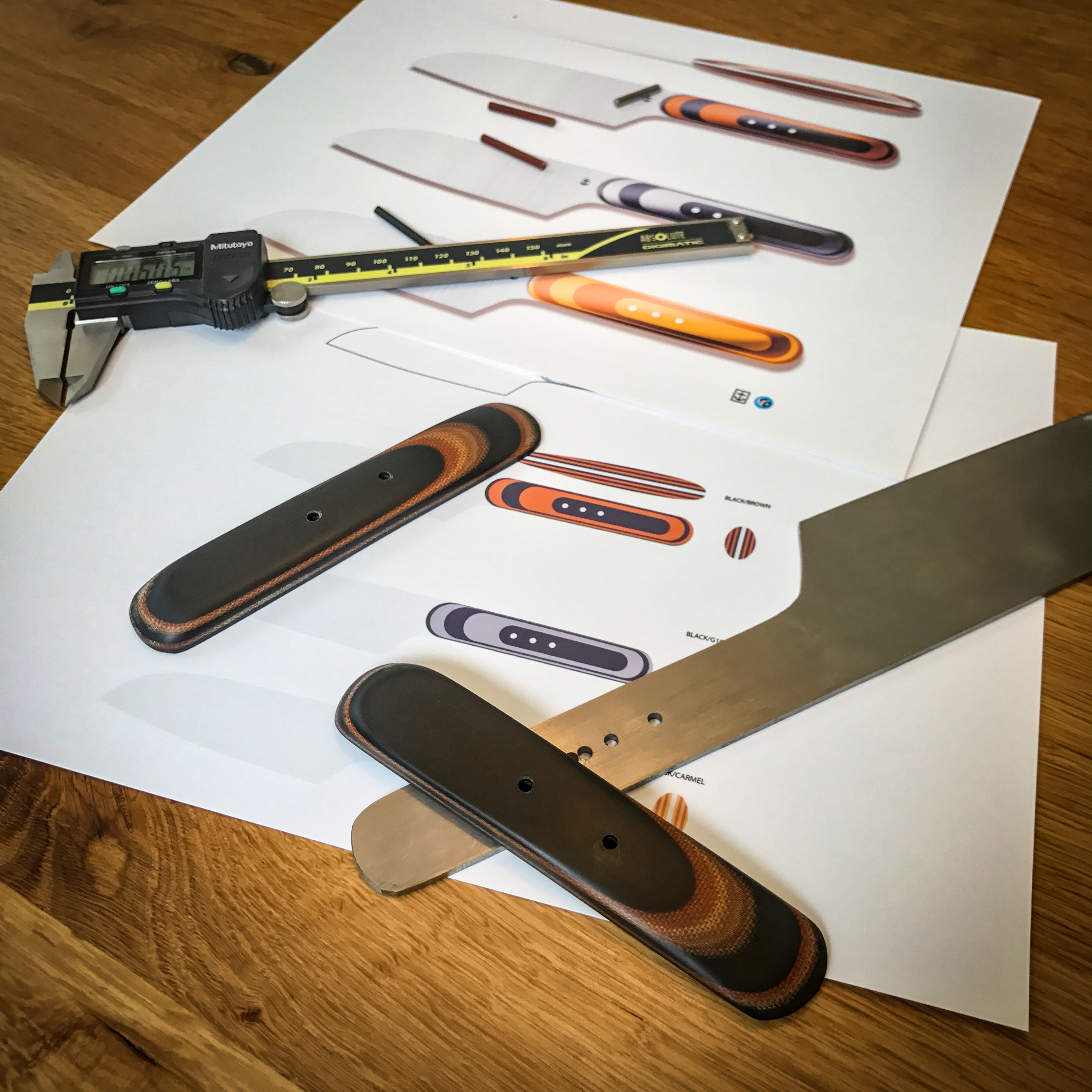

Speaking with the maker, he thinks we can do just one pin. Haven’t had (made) time to do mockups yet… laziness. I need to do it.
Yo Micheal, how are you?! (was it you I ran into at the core77 conference on the bus?)
I love this project, and Chef’s knives in general.
Seems like you’re in that stage of detailing out the surfaces of the handle.
The grip of a chef’'s knife has always informed the final beveling of handles I’ve worked on, it’s a tough balance of simple, beautiful and functional.
Chef’s knives are supposed to be held partially by the heel of the blade stock like the picture.
Most folks at home don’t do this, and I’ve always wondered why because it allows for much more control.
I’ve hoped that someone could come up with a handle that could help map the home-chopper to adopt this best-practice grip position.
As someone who’s spent some serious time working on kitchen tools, It’s very hard to beat a good Chef’s knife - a serious must have.
You’ll have to let us know when this project sees some production: Would love to own one.

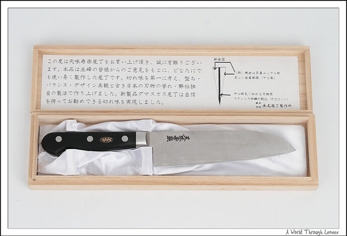

I think you may be mis-understanding some knife terms. Your knife absolutely does have bevels if it is sharpened. In knife terminology, “bevel” doesn’t indicate the large visible slope that one might call a geometrical bevel; “bevel” indicates the surface that has been ground at an angle to the vertical plane of the blade. In the case of the Japanese single-beveled knife, the blade is thick, so you can see the gigantic bevel. In the case of a western style knife, the blade tapers to the edge from the spine, and the actual edge itself is sharpened on both sides, so if you hold a magnifying glass up to the edge, you’ll see that there are two bevels on it, though they are small. It is possible to make a thin, wedge-style blade where the inner face is truly vertical, so it would be single-beveled, but would not look like the Japanese style blade where the bevel is visible because the slope of the main surface goes all the way to the spine, and the actual fine edge grinding is small, but only on one side.
The fact that a western style blade is a wedge and is sharpened on both sides of that wedge makes it double-beveled. If you use such a knife to make thin slices, you will see the effect I was telling you about: instead of making thin vertical cuts, the bevel on the inside will push the blade out, and you will make wedges rather than truly vertical cuts.
For the sake of understanding the ergonomics and functional characteristics of the difference, may I recommend an experiment for you? Get a characteristic western knife or a double-beveled Japanese knife and a single beveled Japanese knife. (You should be able to obtain cheap single and double beveled knives at Daiso (they have them for $5-$8). Be sure to check the packaging for the little graphic indicating double or single bevel grinding. You can see from this one that this Santoku style knife is indicated as being double-beveled:
The ones that are single-beveled will have a little icon or picture indicating that they are single beveled.
Get a potato, a carrot, and a daikon, and try to slice potato chips and similarly sized slices from each of these. You will feel the difference, and then you can design your knife accordingly, knowing how the different bevels cut. What you will notice is that whereas the blades that are single beveled will slice potato chips off of a potato with even thickness, the double-beveled blades will not; the cut line will veer outwards and you will get wedges rather than slices.

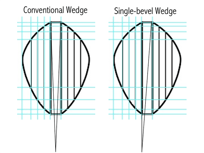

Last entry on bevels / facets / wedges and tapers (at least until you respond), I promise.
I took the drafted picture of your knife’s handle, and drew in a couple of blade geometries to illustrate what it is that I’m suggesting. I’m suggesting that you use a single-beveled wedge shape for your blade, and that the actual sharpening (all the other bevels that may be added in the course of sharpening) are on the right side only. This way, the blade can make thin vertical slices without the problem of the inner bevel pushing the blade outwards.
Admittedly, this will make the blade non-ambidextrous; you would need a version for right-handers and one for left-handers, but for chopping and thin slicing, I think the difference is observable. A right-hander cutting a slice off of a firm item (potato for example, or even a billet of firm ham) using the blade with the cross-section on the right will get a perfect slice; cutting a slice off of a firm item using the blade with the cross-section on the left will give you little wedges as the cutting edge slips outward. You’ll know what I mean when you’ve tried this a few times with blades of each kind of cross-section.
Thanks. But I’m just designing the handle, not the blade.

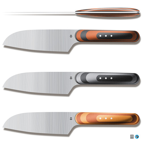

This is a gorgeous design. I like how the handle and blade connect and the back tip of the blade has a forward angle making it less pointy.
Getting the translucency of the handle right will add to the aesthetic. Also thanks for the explanations on single beveled knives, now I know why I don’t get those perfect brunoise cuts. I would love to see a set of those, including a manual diamond sharpener.

Slop back burner project, I just work on it a little bit at a time. I got some input from some professional chef’s about grips they prefer. They actually preferred the very first concept so I’ve been iterating on that.

Love seeing the progression here, looks great! Have you explored the Japanese Style WA handle at all? I got my first WA handle Gyuto recently and I find it very comfortable.

Digging the new design with the three dots and circular ends!
If you decide to laminate layers of balsa wood sheets, I was thinking it might be helpful to put a drop of food coloring or ink in the wood glue used so you can clearly see where the boundary of each layer ends.
Looking good Michael! It’s not clear to me how the back tapers down right now. The pinky and back of the hand can cramp up if there’s not enough material back there. Depending on the handle material, tang, and butt design you go with, you may want to consider an endcap for balance since all of the rivets are pushed forward at the moment. Curious to see how it turns out.
I realize I haven’t updated this in awhile.
Some recent stuff.
Super cool!
What’s the handle material? I really like the texture too it. Kinda gives it a dot matrix look. Have you tried a full gradient from dark to light instead of with the darker stripe in the middle?
First thing I thought of was the old CBC logo… (and also Air Max 95/97)
Good idea Richard. I’ll have to play with that. The material is called Micarta. The solid layers are compressed recycled paper and the textured layers are compressed recycled canvas. The colors are pretty limited because the stuff was originally designed for industrial purposes. It gets grippy when wet though so chefs love it for knife handles.
