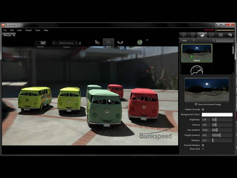

The stuff that sold me on Shot vs Keyshot was the scene building stuff. It’s not the most hyped feature, but check out this vid. It improved my workflow tremendously. There’s also a symmetry feature, like the Mirrored-layer thing in Alias.
Another good thing is that it kinda works like Maxwell when rendering big a$$ hires stuff - set the time to 99 hours and walk away, save an image when you think it looks good enough. Or set it to X time, and if it’s not clear enough, add some more and continue.
The only thing Keyshot has got on Bunkspeed is decals imo. If that’s super important to you, get Keyshot. If you can manage with the usual texture-map-on-a-material-decal then there is no reason to get Keyshot over Shot imo.
