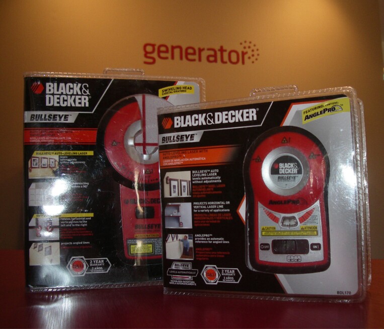

Some designs have addressed the ease of opening and POP security…

That’s an excellent example Scott, in fact I just purchased this very level and found the reusable package to be really well executed. Finally.
Glad you like it Lew - it took months of negotiation with B&D’s packaging and marketing groups for them to buy into the concept, we designed it from sketch to packaging engineering - and because I had designed that line of laser level products it was easiest to get it into two of those SKUs - they’ve since used it once more, on one of their household products. I noticed Stanley also copied the concept on their competing laser level (pre merger/takeover of B&D), so it must have fared well with consumers during post purchase research.
oh, the level works pretty well too
