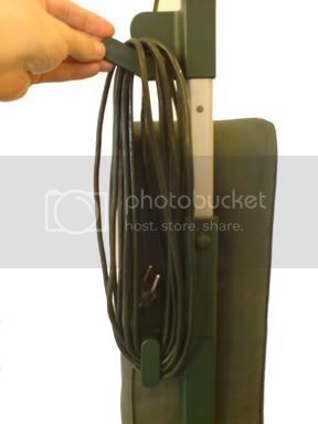

If you wish to keep “mechanical complexity” down have a look at the solution of the “Vorwerk Kobold” vaccum, that I portrait below:
I think the pictures speak for themselves. In my opinion it is a simple and clever way of cable
storage, but has the downside, that the user is responsible for laying down the cable in a routine
way in order not to damage the cable. Furthermore users tend to overtighten the cable in this
kind of clamp what would break the leads inside the cable.
So it is for good reason, that most electrical devices, that come with cables of certain
length, include solutions that are a little more complex but offer a protective and tidy storage.
Given that the cables in EV Stations will be of fairly high voltage one wouldn’t want to expose the
user to any risks.
