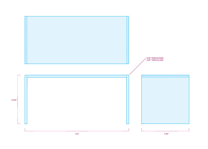

I’ve been working on a lamp design, and this is a bent piece of glass I’ve been looking to get made.
My search has already taken me across the nation (via email), to people specializing in glassblowing, stained glass, cast/molded glass, bent glass, and more. No one has been able to take on this task, and I’m beginning to think it’ll be too difficult to pull off using glass.
Sure, the easy answer would be to just bend a plastic sheet, but glass has such a fantastic feeling, is more environmentally sound, and will add a much greater value to the piece.
Any suggestions of how to pull this off would be fantastic,
Thanks in advance!
-Craig

It’s in the 6x6x12" range, but I’m completely open to modifying the design so it can actually be made real.
This should help, some dimensioning:
I imagine it might take some experimentation, and lots of broken glass… and in that case, would I just end up with a super delicate lamp?
Perhaps safety or pyrex glass would be excellent, though no doubt expensive and probably impossible to bend.

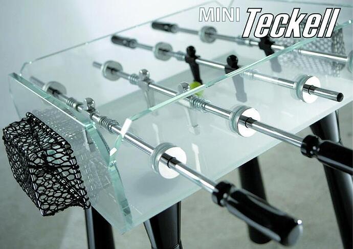

Very tricky, but bent glass tables exist. The glass has to be heated to softening temperature and supported on a perfectly smooth surface to not mark the glass, and it will slowly move with gravity to the final shape. Then it has to be cooled very slowly, a week or more probably, as to not be under tension when cooled. A tight radius like you have rendered, I have not seen before.

Thanks for the info, I actually contacted e-bent glass and they declined because they couldn’t achieve this tight of a radius, and sent me on to two other places, Fox Fire Glass, and Dlubak, both of which couldn’t help me either. Hmm.
I’m planning on frosting the inside surface to diffuse light, so that’s one concern gone!
You may want to look into slumping glass. Basically it’s heat bent over a form. You will probably have to increase that inside radius significantly. Is this intended to be structural in some way? Or just decorative? That may change how everything is done, too.

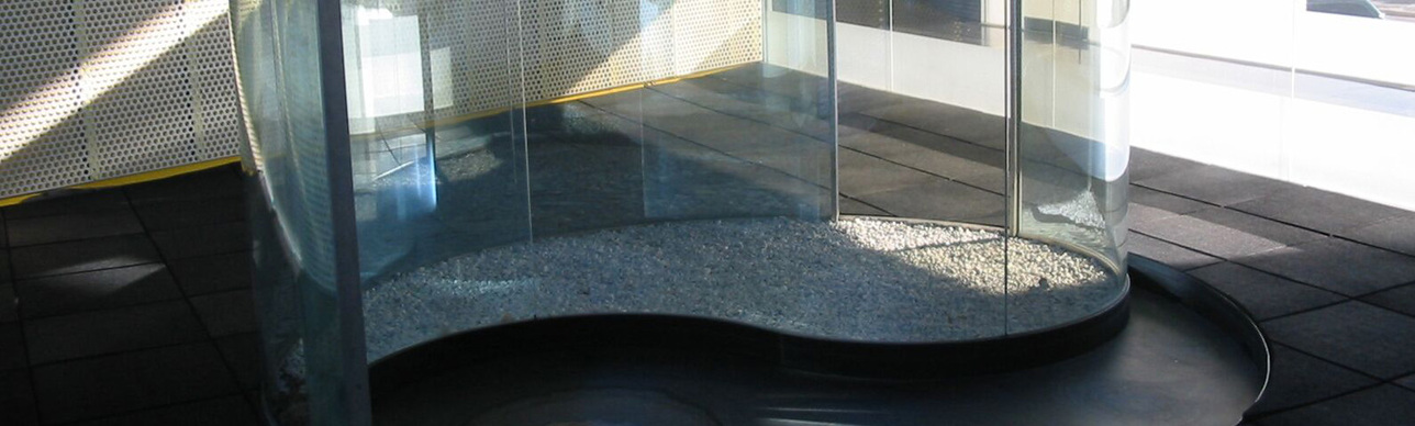

I was thinking slumped glass as a possibility too. However, I can’t recall seeing any architectural slumped glass pieces that have tight corner bends, anyone know of any examples?

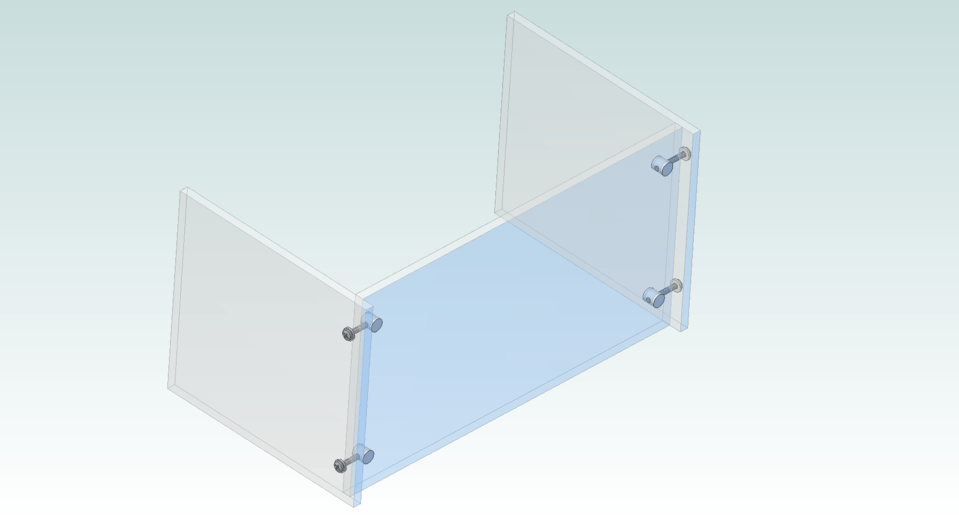

How about something like this? Maybe not the aesthetic you were looking for. Much easier to manufacture, although the fasteners might have to be different or at least rubber insulated.

Interesting idea, but I think NURB is right. Also, I’d prefer not using excess hardware, or anything that would too obviously obstruct light from shining out.
