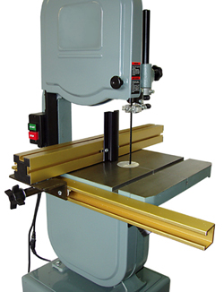

or a band saw with a 14 Tooth/inch blade; blade width determined by what kind of line you are cutting blade; 1/8" for intricate curves … wider for straighter cuts.
