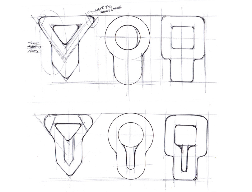

Research - I have a page w/ baby keys and real keys. I will just explain my experience and what I noticed as a parent.
Iterations - Since I have lots of this stuff for other projects, I wanted to make this project concise. I already knew what I wanted going into it. Modernist. Basic elementary shapes: circle, square, triangle. Details that highlight the metal’s shininess.
