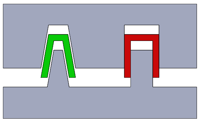

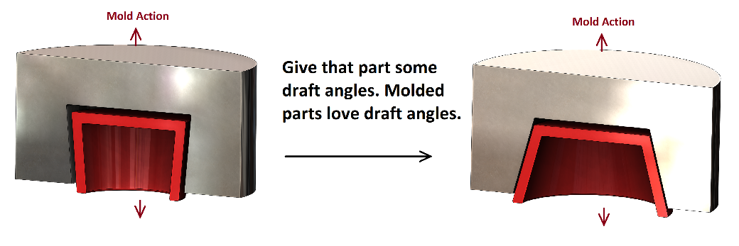

is there any tips on how to avoid draft angle? Im trying to design a 1 part tube shape product around 30cm height and I want to avoid draft angle as much as I can.
I see that there are several product with a very minimum or no draft angle ( apple products ) how they do that? is it as long as its glossy its ok?
Some injection molding companies offer air-assisted ejection. The part shrinks around the core when cooling but then becomes pressurized from the inside to aid mold release. 0 draft angles are possible that way however I haven’t heard of these large size parts. Some companies can do 0.25 degrees draft but anything larger than that becomes noticeable. I imagine this humidifier was done with two mold halves and a collapsible core though.

I am still looking for a factory that can do the 0 draft feature for a product that has been in the ‘concept’ labeled drawers for a good little while but I can accept the .25 as well. The length of the 0 draft is a big factor too, you may want to design to reduce this area.
adding adraft on my design would totally change the look and feel, draft angle would make it looks like its using a skirt ; )

You can get zero draft with parting lines but those would be visible and you wouldn’t get the “Apple” look.

The choice of material makes a significant difference on the draft angle required. I’ve made 5cm long (2.5") parts out of a polypropylene where the toolmaker was happy to make the tool with 0.2 draft. When I say happy, I mean he considered there to be wiggle room in there and so was happy to just make it with so little draft from the get go. I was pleased with the resulting parts.
