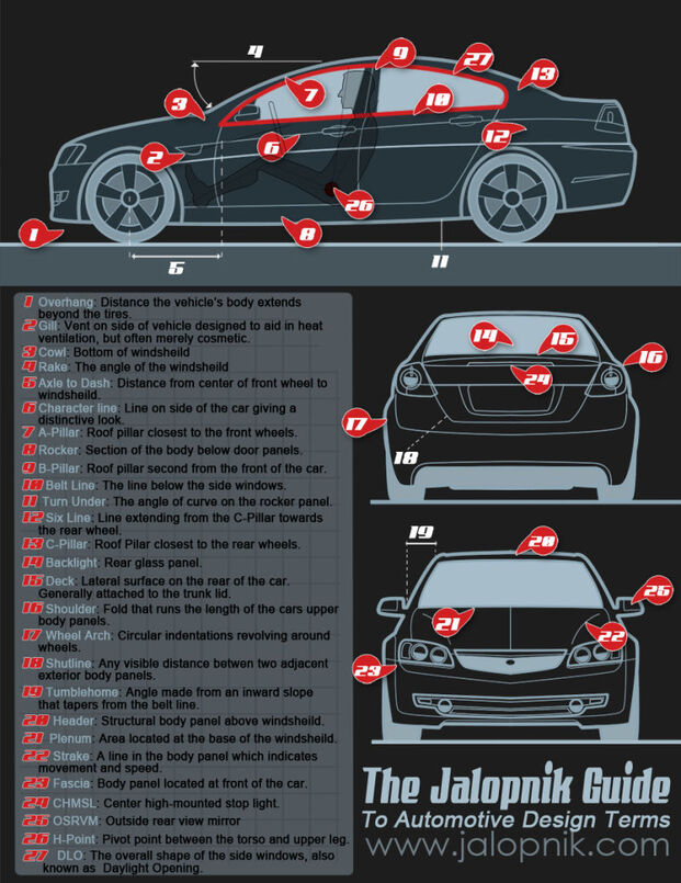

Hey there core77 forum crew. Since we tend to like to talk about cars a lot, I thought iy might be helpful to share some common automotive design terms to help conversations. I pulled this list from the following two links:
My notes in parenthesis.

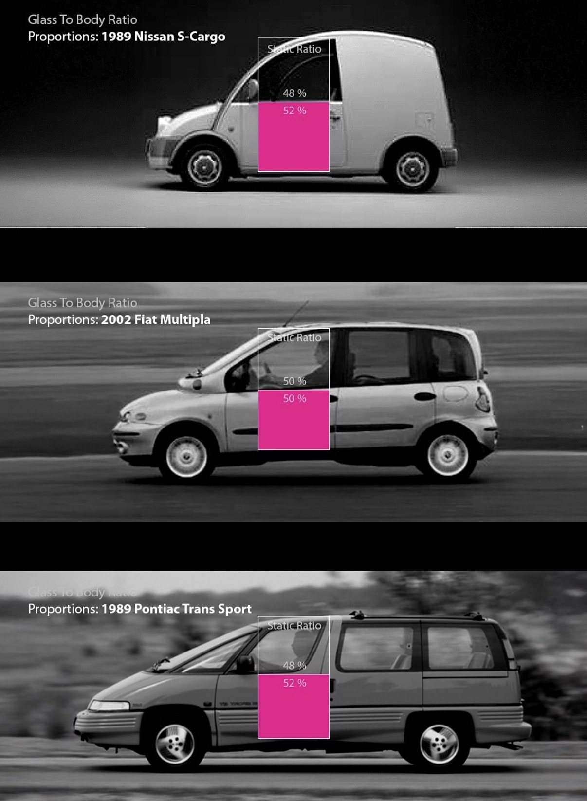

One-Box form
A categorization based on overall form design using rough rectangle volumes. In the case of the One-Box, also called a monospace or monovolume,[1] it is a single continuous volume. Slight wedge formed front or rear are still generally placed in this category. e.g., Bus, original Ford Econoline. The equivalent French term is volume, which you will sometimes see used by the British: “1-volume form”.
Two-box form
A categorization based on overall form design using rough rectangle volumes. In the case of the Two-box form, there is usually a “box” representing a separate volume from the a-pillar forward and second box making up the rest. e.g., Station Wagon, Shooting-brake, Scion xB (2006) The equivalent French term is volume, which you will sometimes see used by the British: “2-volume form”.
Three-box form
A categorization based on overall form design using rough rectangle volumes. In the case of the Three-box form, there is a “box” delineating a separate volume from the a-pillar forward, a second box comprising the passenger volume, and third box comprising the trunk area — e.g., a Sedan. The equivalent French term is volume, which you will sometimes see used by the British: “3-volume form”.

anything missing?
Yes. Missing ‘truck nutz’ and ‘mud flaps’.
Seriously though this is a great list. Keep it sticky’d to the top.
Also an illustration describing the D2A ratio would be really useful especially as we now see electric vehicles that do not need to adhere to these ‘conventions’.
good call, I just switched it to a sticky post.
I always called the ‘leafscreen’ a wiper cowl.
This has always been one of the most helpful list on the internet - great to see it here.
I can check H-point for more terms when I find the time.
