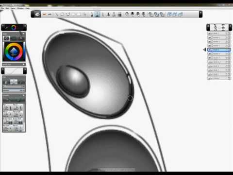

Has anyone used this? - it claims to be a fusion of Illustrator and Photoshop capabilities - which sounds exciting …
unfortunately, there doesn’t seem to be a trial available.
If anyone’s tried this - can you share your first impressions?

in the mean time here are some videos.

I don’t think it will replace SBP as a pure sketching app for the price point it’s at - but it’s a very nice upgrade for those of us who have been pissing and moaning about photoshop/illustrator functionality wrapped in a nicer interface.
Looks awesome. Cant wait to try it out. Love the fact that you are able to tweak the lines you draw.
It doesn’t look like he’s tweaking them so much as dropping vector lines over top of a sketch, then using cleanup tools.
So it’s a bit photoshop+illustrator in one, except just the stuff you actually need for this task.
The difference is that the engine which creates those vectors feels and works very much like the sketchbook pro engine. I know you can create stroke-like vectors in illustrator. Essentially, it has the kind of raster sketching tools you’re used to but those same tools can be used as vectors (on a separate “vector” layer) these can be adjusted like vectors but also edited and transformed like raster. It’s really fluid and seamless once you start using it.

Seems like a decent program for doing those nice finish renderings but not being able to erase with the other end of my stylus is suuuuper annoying. Perhaps I need to fiddle with the settings but it wasn’t something immediately available as it was in sketchbook. Love the potential for quick work flow in vector but I’d like to see some basic shape options. I’ll be waiting for later versions when they can work out the kinks. For now, it’s not worth the money to get a vector version of sketchbook (in my opinion).
features to check out
-Layer folders
-Layer/folder warp controls
-Gradients with warp(pick the edge and move)
-Live layer/folder symmetry
-3D primitive Color Selector with Lighting conditions
-Paper Textures
-layer blending modes
-Airbrush with horizon line preset
-Paintable vector adjustments for pressure, size, opacity
-Export DWG curves
one of my favorites…
WINDOW > ASSET MANAGER (this allows you to duplicate the current illustration, easy way to do variations)
My only current gripe is it always wants to create the window on the primary monitor (which isn’t my Cintiq) any time I minimize then restore it always pops back on to monitor one…same thing if I move it to monitor 2 then hit “new”, the new window pops up on screen 1.
Don’t seem to have any sluggishness issues, but running on an 8 core computer if I did I would throw it out the window.
One other thing - no more ellipse guide? That was my favorite new thing about sketchbook.
hold SHIFT while sketching on a vector layer. it will automatically guess if you are creating a ellipse or straight line.
