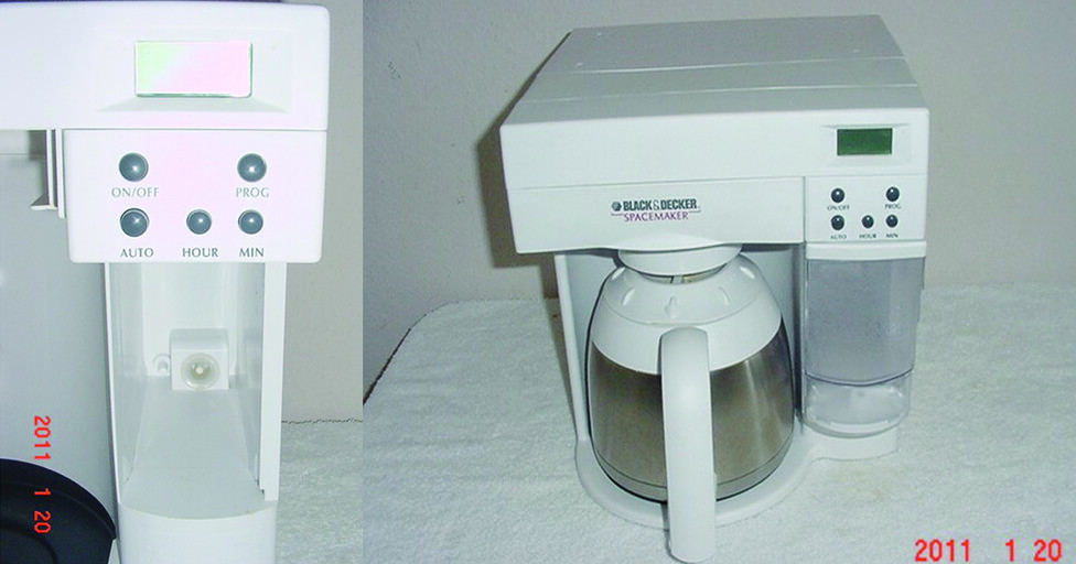

I have found some coffee machines, such as the Black and Decker Spacemaker series, which mounts underneath kitchen counters. Since there is no opening on the top anymore, all entry for water and filter is in the front. In the case of the models I have posted below, the water receptacle even comes out, so that one can refill it and for cleaning. If it is no longer a static vertical well where the water goes down into that “hole”, past the one-way valve and into the heating coils and back up the other end… in the case of this moving retractable water receptacle on the models shown, how does the water “drain out” of it and into the coils? Does anyone have an idea?
I was thinking of buying a used one on Ebay and taking it apart to figure this out, but maybe someone here can save me the expense and time? The only thing I can think of from reading about the features of this particular B&D unit online, is that the water receptacle clicks into place and it must click into something. The photos are from the actual parts of this one unit I found on Ebay and it shows the water receptacle has some sort of valve in the middle inside. Maybe that valve is a one way type, that allows the water to drain when its ready to make coffee? Sorry for the wordiness, folks. Hope I am being clear.

Bingo!
It is opened if the reservoir is in position, no matter if the machine is actually making coffee or not. Additionally, there could be a magnetic float indicating the water level in the reservoir, preventing the machine pulling air.

So it’s that simple, huh? I thought it was more complicated! What do you mean: “there could be a magnetic float indicating the water level in the reservoir, preventing the machine soaking in air.”. Sorry… I am just not that technical.
Thanks!
It’s a magnetically operated switch, a so called “reed switch” which is activated by the magnet in the float as long as the reservoir is in place and enough water is inside. If the water level sinks below a certain point or the reservoir is removed, the magnet is no longer in place and the switch is deactivated → the machine won’t work. This status should then be indicated to the user, maybe by a flashing light, a sound, whatever.
water flows from the tank into the tube that is heated by a resistance coil that also in some forms the warming tray. There is a one way valve in the line so as the water heats it expands (boils) and is forced up through the spray head onto the coffee. The one way valve then opens and allows anther slug of water to enter the tube.
So basically, if the water receptacle is not in place, the valve inside of the receptacle prevents water from coming out (such as when refilling it under the faucet in the sink)? In other words, what keeps the water inside of the receptacle when it’s being filled?
Once the water receptacle is locked in place, the valve opens up, but it won’t completely drain until the machine is set to make coffee?
Did i get that right? Thanks for the explanation about reed switches. I will have to google that.
Thanks guys.
It’s the same thing now as in a coffeemaker with a fixed reservoir. There, the cold water also won’t run through the machine until you turn it on.
