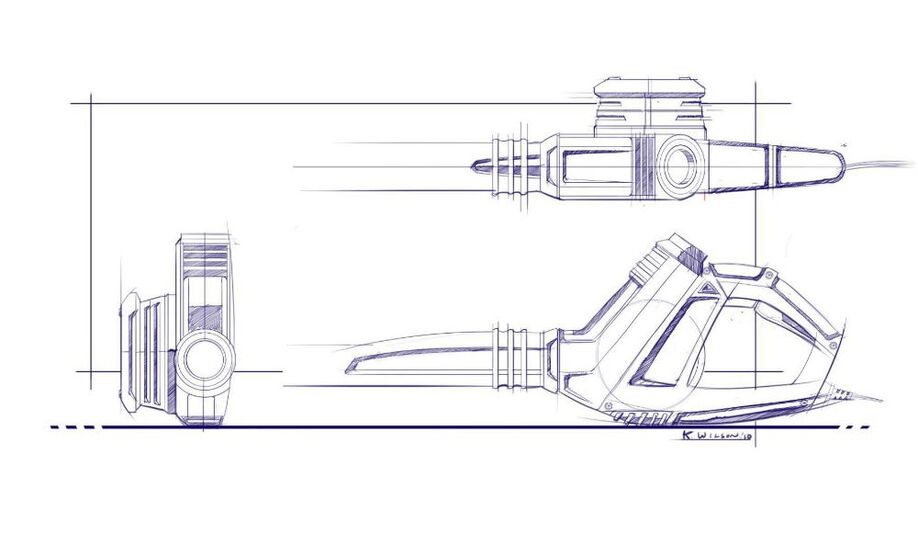

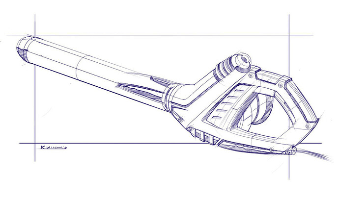

There is no real rule for when and how they should be placed. Put them where you think an important transition may not be clear enough, or where you want to emphasize a form or surface detail. Make sure that they have a lighter line weight than your outlines and key details. Remember when I said that you should keep a visual library of languages and elements? I’ve attached a few images to help clarify my earlier post:
I’m a fan of Bosch’s ID, so I’ll use this as a starting point. I basically took your form language and incorporated a few details from this tool in an attempt to come up with something new. This is a good strategy when you are having issues coming up with ideas. If you repeat this process several times with different form languages/details, you should eventually end up with something different and original. You don’t want to plagiarize or copy of course, but I’ve found this to be a successful strategy when starting a difficult project.
Once I finished thumbnailing, I did a 3-view orthographic sketch to help resolve the form of the blower in my head before I started a perspective view. If the product is especially difficult, then I may do a 5-view. You will likely alter certain details/features as you begin to sketch in perspective if the design isn’t working out as you had planned.
Once I started the perspective sketch, I changed around a few of the details as you can see. After you get to this point, a series of overlays can be done to further resolve the design and rough sketches as you see fit. I hope this gives you a better idea of what I mean by details like fasteners, radii, chamfers, material separations, cross-contour lines etc. Keep sketching!
