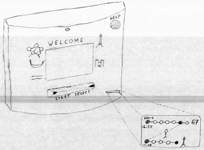

Hi all,
Thanks for the great comments so far. As recommended by Athoms, I thought of an idea that I could improve upon.
I travel a lot and I find that the quality of the transit maps vary greatly from one city to the next. For the average tourist, it makes it difficult to find your way around. Even for locals, it is sometimes difficult to know when your bus will arrive. So I imagined a transit help system that can help both the tourists and the locals. The intent of this post is not to show how great the transit help system works but to show a doodle. In a nutshell, the system can provide easy, printable itineraries for tourist by the touch of a simple button. It can also provide itineraries based on street name (like a GPS would). It can put a person in contact with the dispatcher if necessary and it can provide video security for improved safety. This is what it would look like:
I understand this is not the level of drawing that you are normally achieving but is there any hope to make it a trade if I received some training?
Martin
You would definitely need some training.
And as for as spotting a problem. You spotted one. And you got a solution. Albeit just one. A designer should be able to think of +100 solutions for one problem. So think up some more solutions to the problem. (& I’m sure there’s a simpler solution.).
So sketch some more. lots more…you’ll train your drawing skills and exploration/idea-generation.
If you need help with sketching:
Still a work in progress…
Or some inspiration:
T
Hi Athoms,
I depicted a single idea here but I had several more ideas. I guess I shouldn’t have held back. My ideas vary greatly depending on how far the customer wants to go. Additionnally, there is probably a need for more than one solution. The solution at a major transit point will likely be different than the one at a neighborhood bus stop. Here are some more:
  • Installing a board with pre-printed cards of popular destinations that indicate the route to take
  • Using an e-ink screen that shows the routes available at that stop (interactive or not)
  • Setting up local wifi access-point so that people with smartphones can connect to access the bus maps
  • Providing a RFID or similar device that vibrates once the user has reached a transit point (similar to flashing drink holders in bar)
  • Using a low-frequency FM radio that speaks out the schedule
  • Have a wired phone that reads out the schedule or can call out the dispatcher at the press of a button
  • Prepare a kiosk running the transit company application on a smartphone
  • Prepare a IETF standard that standardizes this bus scheduling that allows easier integration of this data from one city to the next
  • Finance the cost of the solution by adding publicity on the device (physically or on the software)
  • Integration of scheduling information between bus line companies (eg STIB and DeLijn) is often poor. Unifying the databases using XML would help resolve this.
