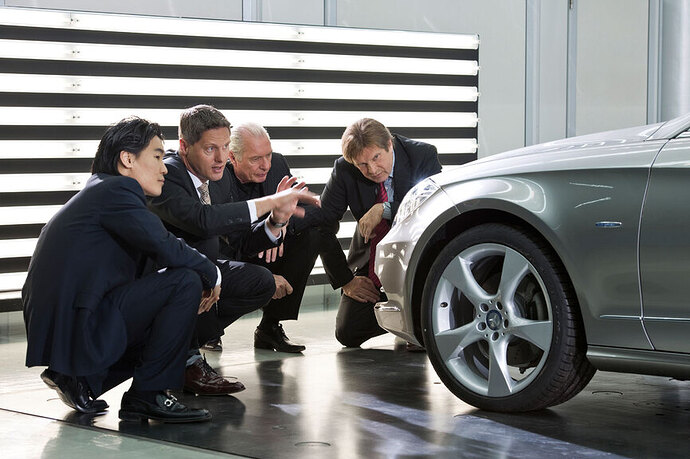

I think that those lights are used for evaluating “surfacing”… maybe the’re pretending to make zebra visualization more clear to the eyes … by the pictures it seems that these “light panel” can be moved from varies points around the surface plate…
is this a kind of real zebra?
the effect is similar
the zebra stripes that you see in most softwares have this texture projected from the point of view of the camera. its not a fixed position like the photo.
Iso-Angle and Linear Reflecitons would be more accurate examples because they originate from a fixed position.
It’s kind of funny to see those photographs too, because I mean, does any customer really care about the highlights so much as those designers are scrutinizing? Makes a person wonder…

Those light panels are cool. I do something similar in a virtual space using Maya to get rectangle panels to reflect outward from body surfaces. Not so much for zebra reflections but to make the auto paint reflections more square thus making the paint look more shiny. I hate to see defused specular highlights on auto painted surfaces.
