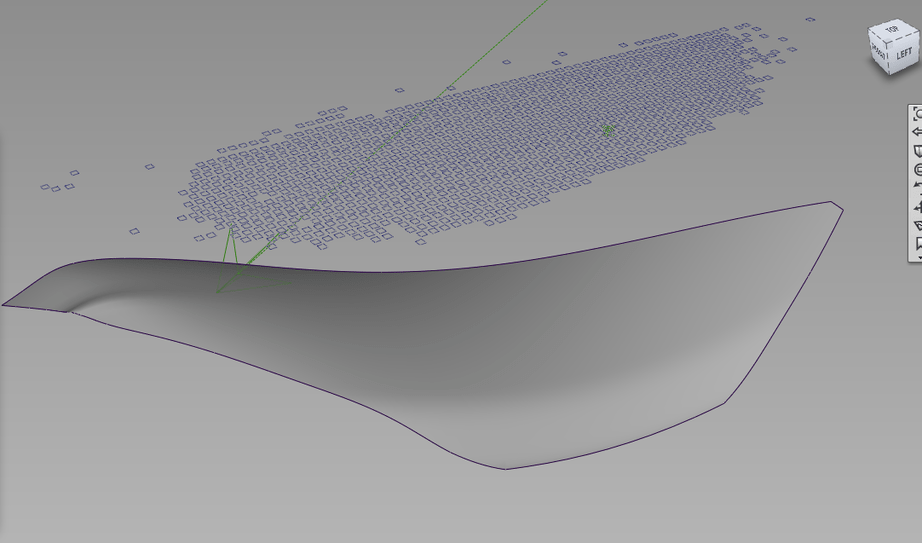

I have a surface that I want to turn into sort of a “mesh” but not the CAD kind of mesh. The mesh like your window screen. I’ve drawn and duplicated a curve that is a square (closed) and arranged it into an array (there are about 1000 of them). I want to project them onto the surface and then trim it away.
HOWEVER. Something’s weird and not all the squares are trimmed away after I project and trim. Even when I projected, a bunch (like 30) of the squares have some kind of weird squiggly curve over them (can’t screenshot because it took forever to project, and I undid it so I don’t want to do it again).
Even when I try to Planar the square curves before I project them, not all of them can Planar (the curves are closed, I swear!). It just says “error creating trim surface”.

I would try rebuilding the squares. It looks like you used a continuous curve which made a mess of the CV’s in the corners. I would try using 4 segments to get the shape you want, then duplicate it to your hearts desire, and then re project and try try trim.
See picture.
yea i had a problem figuring out how to draw a square… you mean 4 segments like 4 straight lines overlapping, and then trimming/joining?
quickest way is to turn on your grid lines. Go to top view. Create a new Edit Point Curve (3 degree is fine) Make a new curve that snaps to the grid (hold Alt while clicking). This will give you a straight line segment. Make 3 more individual curves that all snap to the grid. This will give you a perfect square made up 4 curves, which has all 4 corners snapped to the grid. Then group and duplicate this as needed.
When you go to project them, instead of clicking on every single curve segment (4 parts per square x 200+ squares), just drag a box over all the squares. Hopefully this will work.

Brett_nyc is right on. Your curves are messy and just confuse the projection and trimming algorithms.
There is a rule in Alias that will save you time and headaches - modeling clean and simple. The cleanest and the simplest your geometry the less they are charged with complexity in mathematical terms - which means simpler and faster (and more successful) computing.
For a square or rectangle you could also use Curves > Keypoint Curve Toolbox > Rectangle.
You guys were right. It worked like a charm.

the curves that you are trying to use are not that clean. is that the shape that you would like? there is 1 rounded corner, the rest are sharp?
SINGLE CURVE
to build these with a SINGLE CURVE use 1 degree curves and snap the end points together so they are touching and complete the rectangle. i used the Curve Rebuild tool to rebuild them all to 1degree x 4 spans. all though it changes the shape of your curve, it worked just fine.
