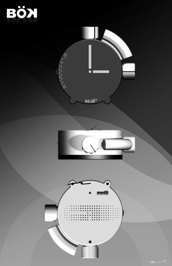

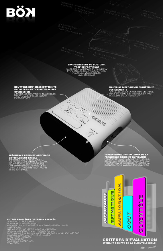

New project done for school and looking for a design oriented electronics fabricator to help me make this design come true and offered to the public.
Image 1: Analisation of the design disaster (Pony CreamMachine …)
Image 2: Solution according to the target market which is the working class that has a certain design concern
Image 3: The boring part of schoolwork, although necessary 1:1 scale on Tabloid format
Comments por favor!
Sorry it’s in ze French language !!

It looks like it uses an impossible display technology (high resolution and round?) What was your intent here?
I like the Dreammachine. It wakes me up. Its got a dimmer on the green lcd. It sets itself. The alarm is easy to set. What is there to hate?

@Nurb: Funny that you say that because I myself have a dreammachine too but not that particular model the teacher selected which was a horrific amalgam of buttons which after 5 minutes I haven’t figured out. Mine I guess is a newer model. I’m pretty satisfied with it, it has half the buttons on the one selected. Although I don’t like the looksf of it even if it’s not it’s first purpose.

Overall I think the graphic design and the presentation is pretty good. I love the fact that you integrated sketches in the background so we can follow your process a bit. The overall form is really clean and reminds me the archetype of the alarm clock. To me the emphasis you made on the 3d graph of the evaluation criteria may be a bit too much.
Did you do a mock up for this project? Is there enough room for your fingers between the snooze and the turn knobs? The other thing that I question is the positioning of the snooze button. Because it is on the side, will the alarm clock move or tip over when you will push on it?

I personally find it unfit compared to the rest of the content but its just to pull the attention there since things that are located in bottom right corners tend to be ignored in our western left-to-right reading civilization.
Although i must admit there is some things you pointed out I have to reconsider. As for the stability while pressing on the snooze button, it was tested to be stable with a foam volume model
Thanks a million!
The snooze bar is in a non-conventional location, making it harder to find by feel. Also, because the force required is not top-to-bottom, the clock will slide to the left when pressed.
I don’t think you should bother with an indicator on either knob–volume is obvious (up, it gets louder) and mode should be made obvious from the front-face, not the top (no one will look at the labels on the top.) I do think that you’ve got the knobs right: the volume knob orientation leverages the natural-mapping principle, and the mode indicator is at the top.
The aesthetic is nice. I presume it’s intentional that you borrowed the design-language from the original dream-machine? (With the distinctive deep black lens.) Hopefully this is because you intended it to be for the Dream Machine brand, and not simply ripping it off. …But this isn’t clear.
The metaphor reference of an analog clock is intuitive and appropriate.
The radio tuner dial is unresolved and does not match the aesthetic. Make it oversized at least! (PS: radio is old-school–I want MP3 or Internet Radio!)
The vents on the back are linear when everything else is radial. This doesn’t seem to fit.
Eliminate the parting line–you already have one with the front lens, don’t give us another! This makes it a three part clamshell when you only need two.
The display technology is unrealistic as I’ve mentioned. This is a big problem that needs to be resolved.

You must understand that this is a school project, and when it comes to school projects, there’s a ‘‘teacher’’ factor. The fact that i have a frontal clipped lens and old school features is based on the teacher’s choices. There was although no intent to imitate or to create a continuity to the dream machine. the inspiration came in a funny way from the Wall Street Toro.
I guess my design was more aesthetically oriented. If it was up to me I would put an mp3 player and use advanced display technologies and make it a design gadget. But there was also a price range to respect and that’s the result.
Speaker holes: I just like to break the mold sometimes
Part Line: Teacher factor
The volume knob is also to set the time or alarm. Electronically it would give the value + or -. And the mode, once you know where each thing is you don’t need to read it anymore. But sure everything can be made better! just… need…more…time and more brains on it to spot problems:P

Last comment: as a general rule in product design, avoid modes! Any Interaction Designer will tell you this, but Industrial Designers need to learn…
Modes are a way to cram more features onto one control, and they’re horrible for usability. People have a hard time understanding them and it leads to unexpected behavior from the product. (Example: I want to turn down the volume, but I’m in the time-setting mode and accidentally adjust the time instead, at which point I curse the designer of the product!)
This is especially true for your (mode) selection button. Off/On/Radio/Alarm/Time … What do any of these actually do?
Get rid of On/Off–what do they do? There’s no such thing on a clock.
Get rid of the Radio setting. Instead, the radio turns on when you turn the volume up, off when you turn it down.
Get rid of Alarm and Time settings and provide two separate dials to set the time and to set the alarm (consider the alarm dial will be used more.)
Provide a really intuitive way to set the alarm on or off. I always thought the original alarm clock did this best–you pulled the button up to turn it on, and you pushed it back in to turn it off (this is where we get the snooze bar today, but people seem to have forgotton.)
