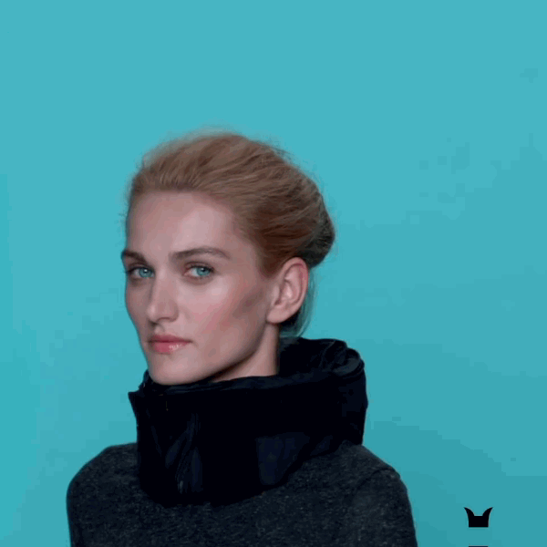

Nordic model looks serene and unblinking as an exploding helmet surrounds her head.
It seemed an impossible product, a head airbag that would sense the perfect time to inflate in microseconds.
From sensor pre-impact logic, the reliability of electronics, coverage, the tradeoff of wearing a bulky collar instead of a helmet. How often will it inflate in non-collision situations?
The Hövding contains accelerometers that detect unusual movements which then deploys the airbag if the movement patterns match the profile of a crash.
I never thought it would go past the concept stage. Then it did, and my skepticism became 5% less. Awards followed, cool marketing with very attractive people wearing the magic protective collar. The triumph of youthful designer eyes and faith in technology to somewhat magically protect other people’s heads.
[ The large distance to slow down a head is optimum, that was the one fantastic point. ]
My skepticism has been recalibrated. I’m a little sad it wasn’t real.

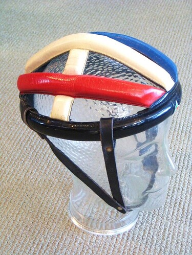

The thin, or minimal helmet has been a recurring product theme in my design sphere since my awareness began. The very first helmet that appeared in my wtf designdar, (desdar?) was a thin set of leather pads that bike racers wore in the 70s called the “hairnet helmet”. Sleek, stylish, and completely useless.
