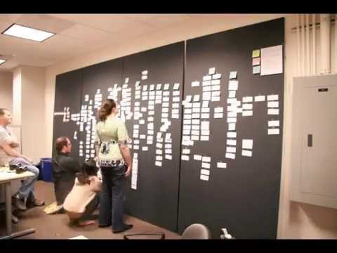

Yesterday I led an affinity-mapping session at work, and created this fun time-lapse with a computer-controlled still camera.
(I’m the big guy in the black.)

As the moderator, you shuffle and evenly distribute the cards. You then put a random item on the board, and ask your helpers to find anything that matches that item in their own decks, begin careful to group by behavior rather than simply keyword-matching.
After the groups start to form, you label the group with a post-it, using the users own first-person voice. There are three different color post-its for three levels of categorization. Blues are described by Pinks are described by Greens. After you’ve got about ten groups on the board (ie. enough branches to hang the leaves), you invite your helpers to start building on their own (in this video, it happens at 0:18 seconds.) No one owns items or groups, so everyone is free to re-arrange as groupings take form. Note that I’m using 4x8’ Gatorform panels, which work really well because they’re waxy enough to that the tape can be repositioned, and they’re lightweight enough that its easy to re-arrange (like we did at 1:07.)
