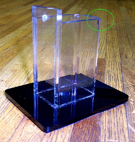

But mw, you didn’t mention what the bend radius is that you are attempting to make … 1/2", 1" … a huge 10" radius? Larger?
Another thing you need to understand about bending “plastic” is that when making a “free bend” (no form to control the flow of material) the “inside” radius will not be parallel to the “outside” radius. This happens because as the material at the outer surface of the bend stretches (flows), the material toward the inner surface compresses; the result is that the material at the middle of the bend radius thinner.
It is not as pronounced on thin thermoplastic material (up to about 3/32"), but it is there. It becomes very pronounced on thicker materials; > 1/8". The larger the radius, the less the stretch (less, not eliminated).
This occurs in sheet metal as well, but is not as pronounced because the metal is less fluid than “plastic”.
_edit __
If you look closely you can see this in this pic … granted, 180° is an extreme bend.
You’ll also get these droopy corners…
droopy corners…
