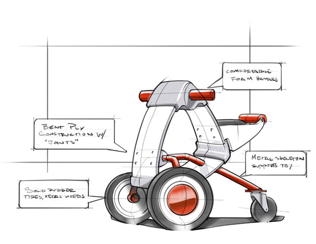

For my industrial design thesis studio at Carnegie Mellon University called Pieces, we need to approach a given area (anything we are interested in) with a holistic point of view, do the research, come up with a solution, and design all of the components.
I am designing a new toy brand from scratch called The Coop. I will be designing and making 3 rideable toys, the brand identity, packaging, and a photo and video shoot of the finished toys in action. The catch is we only have one semester, so it all has to be done by December 10th.
I would appreciate any comments and suggestions from the design community as I start to move forward with the concept stage, since I have to decide pretty quickly on a direction and start prototyping

What’s the age of the target user?

When I first saw your sketch I immediately thought what if the seat is on an articulating hinge and the back caster wheel comes off the bottom of the seat. Similar to articulating tractors or buses. I haven’t really thought it through though might be a pain to maneuver, and I think the hinge would have to be perpendicular to the ground for it to work not like I drew.

Something really bothers me about the caster and being incredibly hard to control.
Im with Nurb, there is a reason why the front wheels of a car or shopping cart are the ones that turn, as opposed to the rear wheels.

I’d think about the user semantics a little closer. A little kiddy, or me, needs to be able to look at it and in 2 secs KNOW where hands go, feet go and butt go. It’s not quite there yet. It might be as simple as color adjustments.
Your “bent plywood+ molded attachment joints + bent tubing endo skeleton” has a lot of potential to be a really elegant 3D composition, but again, it’s a lot of gestures and parts right now that seem arbitrary in relation to each other. Personally, I’d ditch the plastic “joints” and get the plywood parts to do more for you. I think the tubing frame can be simplified a lot too. I’d look at some furniture that uses bent tubing or bent rod to see how to better hit all your hard points in a more elegant way.
Some scale models with paper clips and chip board will help a lot with this distillation process.

I have started thinking of better solutions on attaching the bent ply pieces together, this concept uses wood triangles with mechanical fasteners (which I would probably hide) to complete the structure.
As far as the caster, I probably drew it a bit out of perspective (too far from the main body), it would be closer to the body of the ride on, and I was basing it on forklifts that have rear steering. From what I have seen, as long as both wheels rotate independently, I think it will steer ok. I will have to build some mock-ups and see!

that empty space right below the seat looks like a hotspot for injuries? isn’t there some clearance (jeff told me about it last semester) for fingers? Also not too sure about the cylinder in the back. does that spin? what’s the purpose?
also right now you have screws going into the side of the blue planks of ply… i’m pretty sure that won’t work out too well. i think instead of cutting into the blue piece, you should cut into the triangles and have screws come in from the blue piece’s side.
most of this looks nice, but the part that’s the most unresolved is the castor wheel area. if you cover that up this looks nice otherwise (although a little sharp in certain places for a kids toy)
Yes, but on a forklift that rear wheel doesn’t rotate independent of steering. You can turn that wheel and hold it in position. With a swivel caster, no matter where you place it, it will rotate freely where ever it wants to. If you find away to link that to a steering mechanism, this concept would have much better chance of working. In my opinion.
If you’re asking a 3 year old to hop on and try to get somewhere, they might have a tough time.

OK, to be critical, why molded plywood? Looks like you plan to paint it gloss, getting rid of the beauty of the materiality, and the bent arcs are so shallow, they might as well be just flat pieces of hardwood, or minimally shaped
My suggestion would be to either ditch the ply, or develop more of a reason to have it, and show it off.
Agreed that there seems to be some potential pinch points that just don’t need to be there.
I don’t mind the idea of back caster, and it could be fun, but you have to spec a caster that goes with the design and not be limited to Home Despot. Check out Doug Mockett’s online catalog, a lot of fantastic casters there.

Nurb - I think you’re taking the caster a little too seriously. As a ride on TOY, this is not really meant for going to grandma’s house down the block. I imagine this more of a toy where you just scoot around on the driveway or indoors, doing drifts and whipping around with the caster.
It all depends on the target user age. You there’s a good reason that scooters like this for 1-2 year olds have fixed wheels. If this is larger for a 4-5 year olds (or older), who already has a well established sense of balance I don’t have as much of an issue with it. I’m assuming that this is for the younger set. Am I wrong?
Nurb, My target user is an active 4-5 year old, a kid who already has a well developed sense of balance, and will want a ride on that is just one step behind a push bike.

I have noticed the pinch points and the more I draw this thing, I think the softer and kid friendlier the forms are becoming. As far as my plywood choice, it was more of a technical ability thing, seeing how we have the machinery here to make those shapes, since our shop is mostly a woodshop(not many metal tools).
But its true, if i’m going to use it it should be more apparent as to what it is. These next concepts have more of a bend, which I integrated into the “hump” shape of the gastank that racing motorcycles have, and this will technically reduce the number of parts.
I wanted to go with a gloss color way since I am taking aesthetic inspiration from fast vehicles, and from doing some existing product research, there are enough high end toys out there that are just naked wood. I want something that will appeal more to the kid, instead of just to the modern parents.
