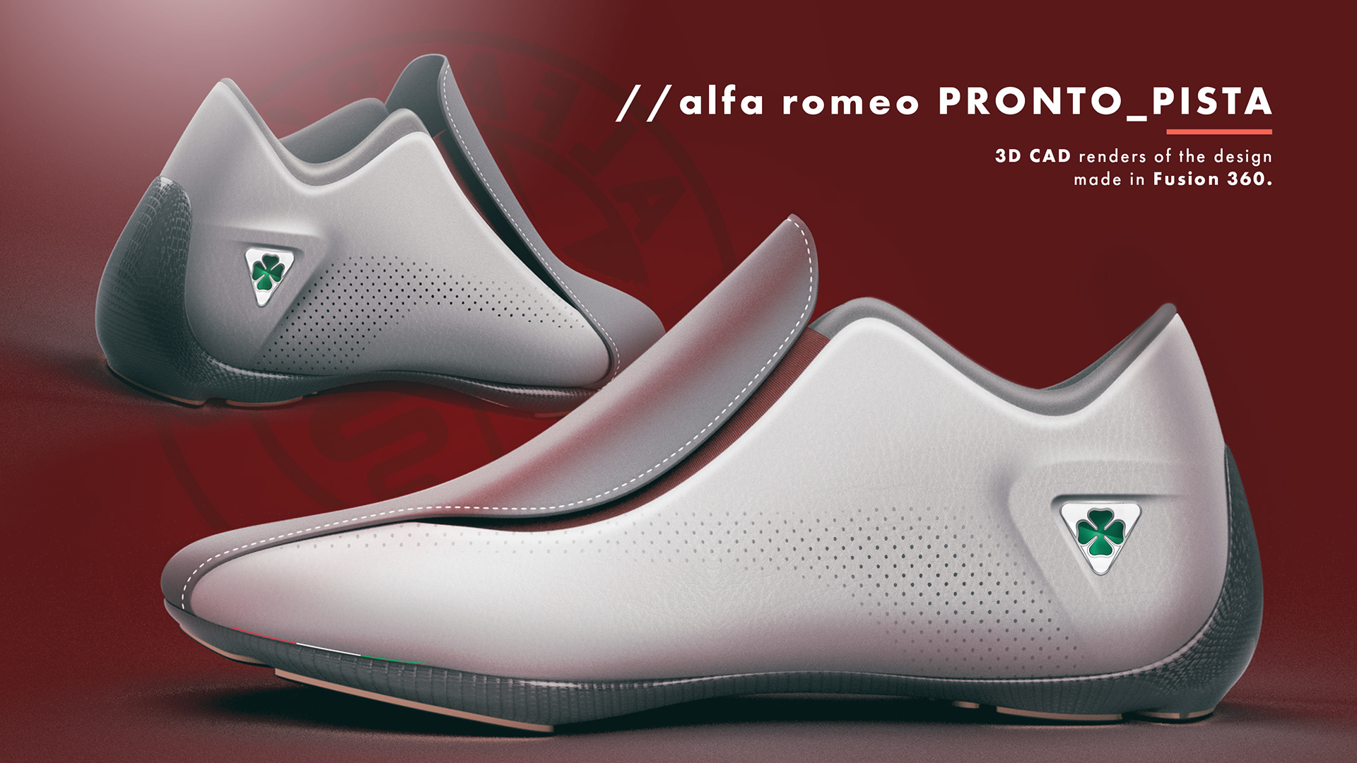

I encouraged a 1st year student with only a little CAD experience (SolidWorks) to enter a competition which required modelling a shoe in Fusion 360 a couple of years ago. A week later they had learned Fusion 360 and modelled an entire shoe, mostly using T-Splines. So, my second-hand experience would say that Fusion 360 is probably a good choice but with Rhino you can get plugins like ExactFlat to flatten complex surfaces into 2-D cutting patterns.
Hey MK19, thanks for the input. I’m not sure how patterns can be draped and flattened with footwear with solidworks either. That makes the plugin for Rhino sound pretty useful. I’ve done a simple shoe model with Fusion 360 for one of my projects once but the fidelity I got to it is definitely only good for visual representation and not so much tooling and so forth. I wish Fusion 360’s generative design capabilities wasn’t locked behind a paywall, would love to try it out. Maybe it’s time to revisit Rhino.
