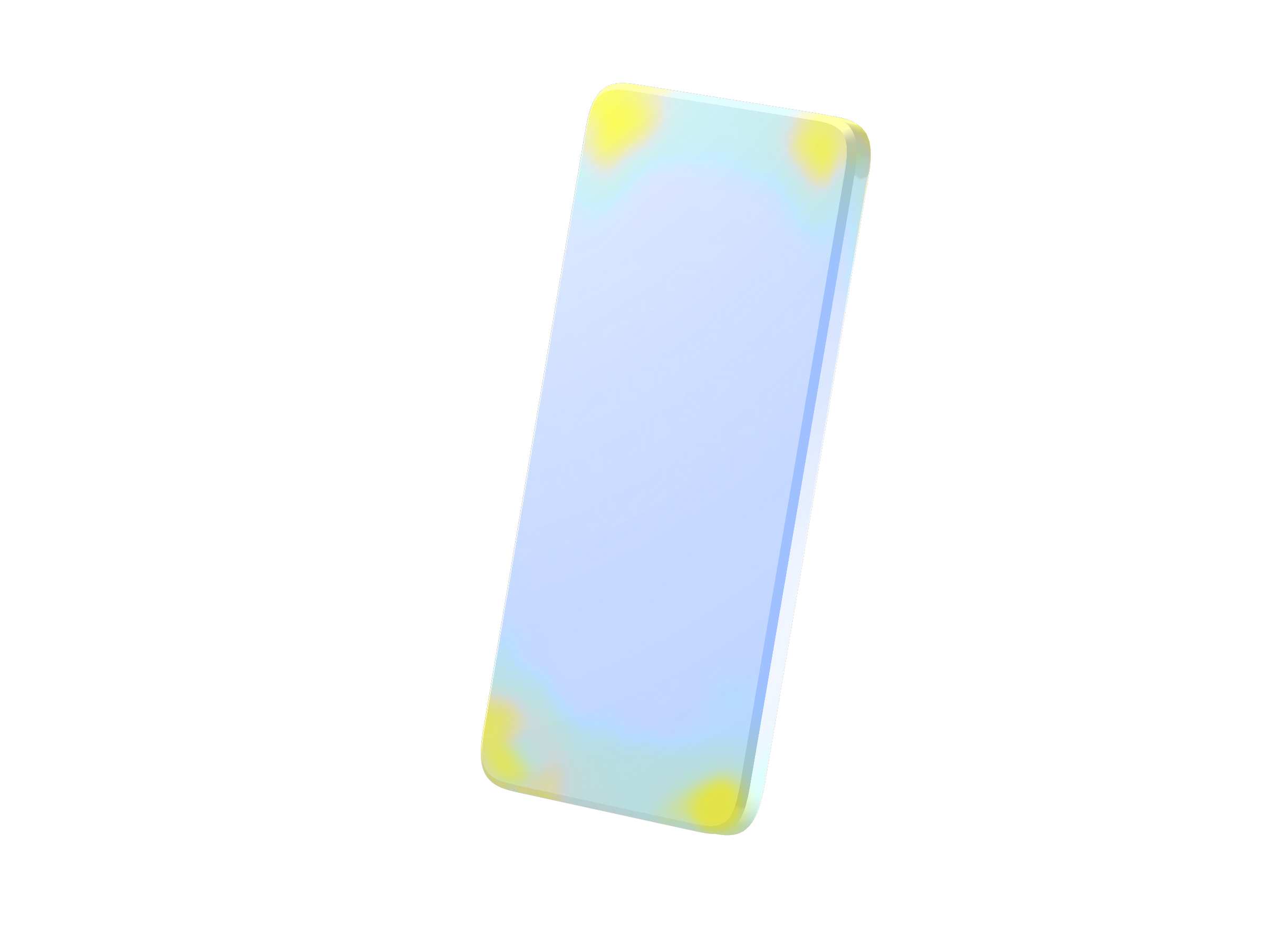

Using anthropomorphic data, 4000 tests were devised representing a wide breadth of typical drop situations across the population. Testing parameters include elbow height, angle and length of forearm, initial angle of phone, initial speed of phone, as well as the possibility for an initial collision with the user’s hand.
The results from these 4000 drop tests were then compiled onto a single impact map.

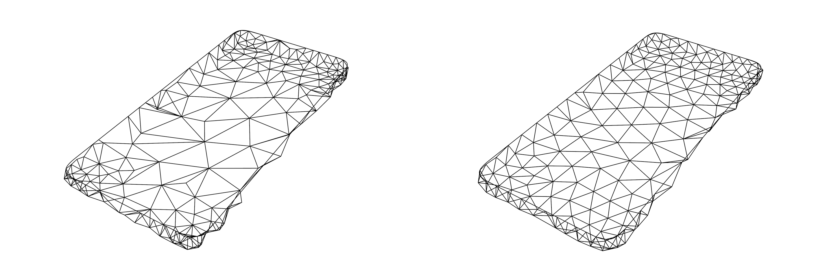

In order to create the final mesh, a set of random points are located on the surface of the phone biased by the impact map.
A purpose built (soon to be shared!) mesh optimization algorithm refines the mesh into more regular triangles while keeping the mesh more dense in impact zones.
The left image being the initial random points seeded from the impact map and the right image after 12 iterations of the algorithm.

Thanks for the response Ralph! I'm hoping to get the first one built at Shapeways soon, I'll make it available for purchase if it's up to snuff. You're right about local impacts, I'm assuming the impacts are taking place against a flat surface. One thing the data did show me which is pretty obvious in hind sight is that the most likely point of failure is probably the corners but on the side of the screen. Not only is the glass fragile, most cases don't have much protection there so not to impede on the use of the screen.
