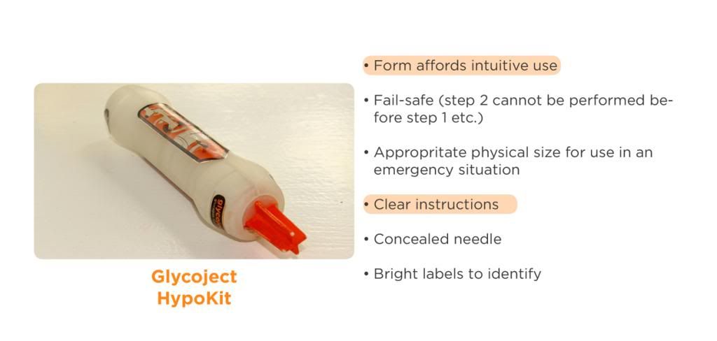

The Inspiration
There is only one HypoKit type available globally. This consists of a separate syringe (containing water) and vial (containing glucagon). Glucagon is not stable (usable by the body) for more than 10 minutes in liquid form, and must remain in dehydrated powder form until immediately prior to injection.
My experience from using the Hypokit was not positive; I was slow, made several mistakes and struggled to understand the instructions, even though I was fully cognitive, had researched the topic, and was not panicking. The current device is relatively primitive, and I couldn’t imagine needing to use one quickly and in an emergency, without prior medical experience, and possibly without having ever heard of a HypoKit Injector before.
The Current Hypokit

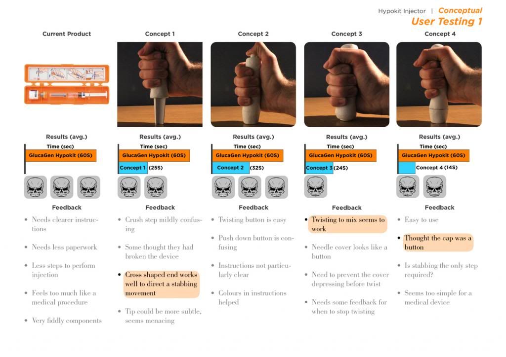

The secondary stage of research focussed on an in-context user test with a dummy and distractions. 30 classmates were used as test subjects to find the primary problems with the device. A general overview was also conducted of the user requirements, competitors, medical product standards (Therapuetic Goods Act 1989), patents, medically-approved materials, production methods and disposal requirements. Sustainability was also researched, but was overshadowed by the strict medical standards of production and disposal. From a feasibility perspective, a market analysis, paired comparison and function analysis were also conducted.
User Test Results
The main difficulties found were:
a)Is too complex to be used easily, quickly and accurately while stressed and panicking
b)Is too small and fiddly to be used ergonomically with shaking hands or heavy breathing
c)Has an exposed needle, this is unacceptable in modern medicine due to the danger of blood-borne disease
d)Has inaccurate instructions that are both hard to read and hard to understand. They also consist of 4 steps, while the recommended maximum for an emergency device is 3.
eAverage Use Time: 60 Seconds
f Average number of mistakes: 3
This user test was conducted in a calm, studio environment, without a real unconscious body. The testers still found it difficult and slow to use and understand. This would be multitudes harder in a stressful emergency situation, where the user may not be cognitive.

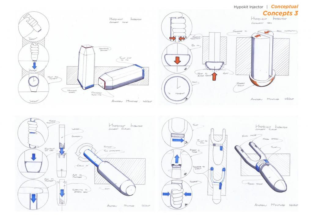

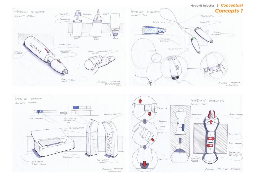

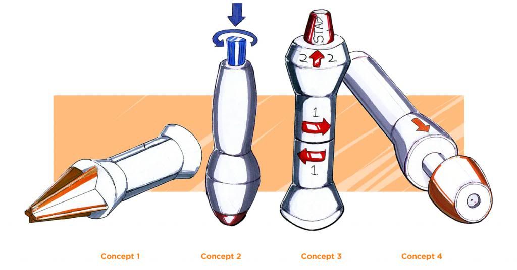

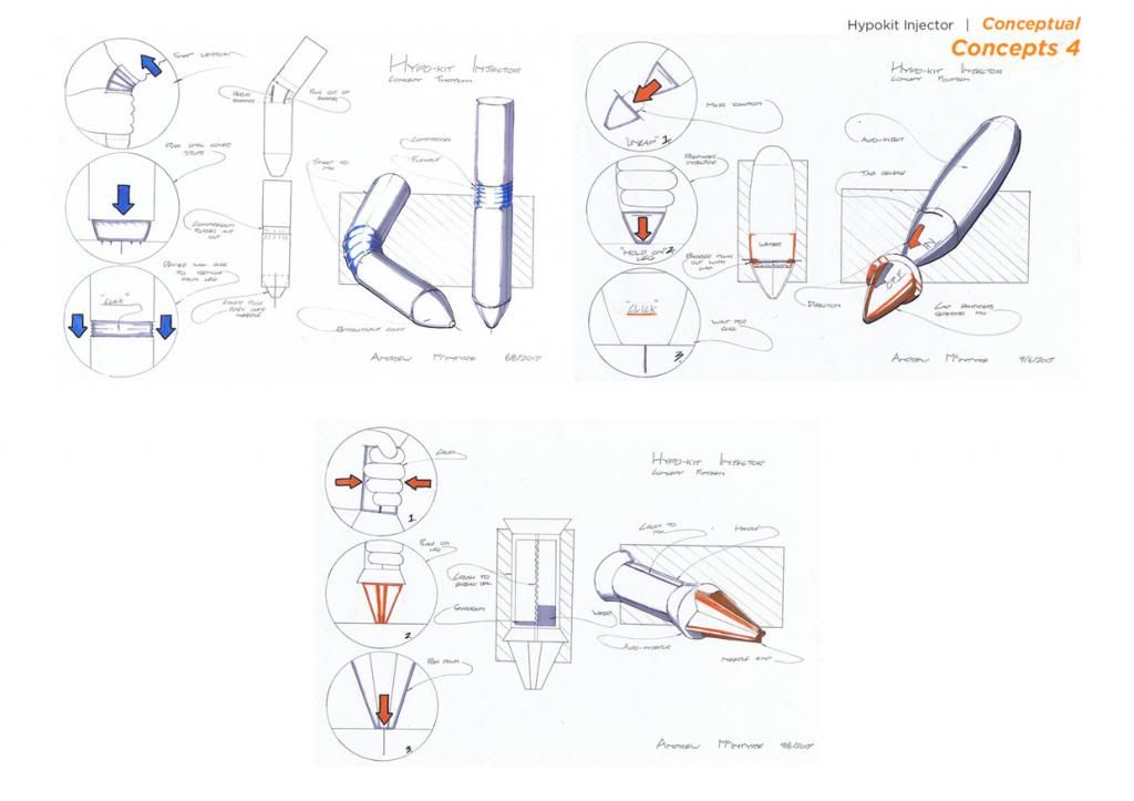

The Concepts
Concepts were focussed on two primary aspects; Exploring how the device would be used with different technologies (even if they were not available), and affording a subconscious influence of particular motions to the user. The user needed to ‘want’ to twist/shake/bend etc. the device to mix the solution, and they needed to ‘want’ to stab the device into something to inject the solution.
I'm going to re-scan the sheets individually to show them in detail, but at the moment only have them available as groups.
The concepts were filtered down via popular opinion from classmates and professors. The 4 deemed most likely to work:

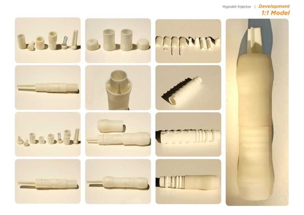

The Development
Mock models of these were built, tested, and compared to the current design.
The features of each that showed the most usability were blended into a final concept.
Development of instructions. A graphic design student worked on this as a very minor project.
1:1 testing of size, fitment and assembly.

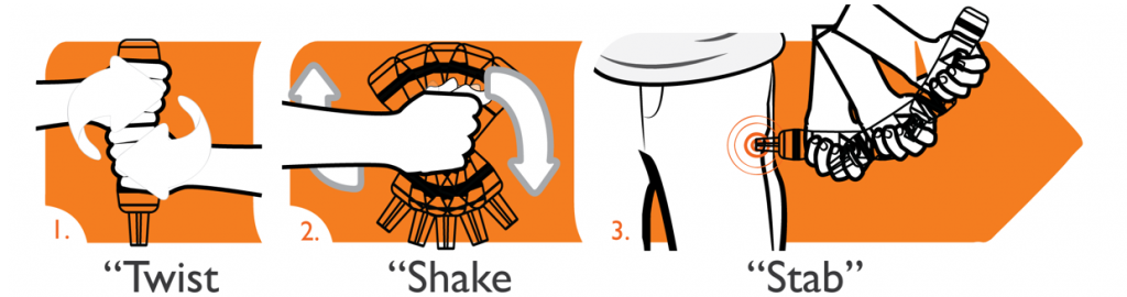

Instructions
Instructions were made as large as possible. The device now also reads 'Hypokit Injector', very clearly. The "shake' step has been removed, as it was deemed unnecessary.
They have not been tested, however I think that they are more usable and are also more attractive (aesthetic usability effect perhaps?).

I think the weak point is the sketch quality. In the ideation sketches it is OK (not great, but OK for this stage) but when you get to the image of the final 4 concepts the sketches are not as strong as they could be.
I'd also watch your phrasing at this stage. Instead of saying "based on popular opinion 4 was deemed the most likely to work" say something like "after feedback and consideration in review with my peers and professor I select concept 4 based on feasibility and usability."

I like the twist and shake steps but "Stab" is a pretty aggressive word. I imagine it is hard to find a proper word that provides an adequate but simple description of the process though. Perhaps "Thrust" or "Drive" might get the message across while seeming a little less violent.

Yo,
I completely agree that the sketching needs improvement. It's something that I've been trying to work on every day before I go on an internship in June. Thanks for the advice on the verbal comm. side of the project!

Stab is a very aggressive word, but it also really impacts what to do for that step. I like the idea of something like "thrust", or even more basic like "push" or "press", it really needs to be a balance between directly communicating the function without intimidating the user. I initially looked at just having the pictorial images without the text to make it as universal to use as possible, but I kept them as a redundant back-up.
