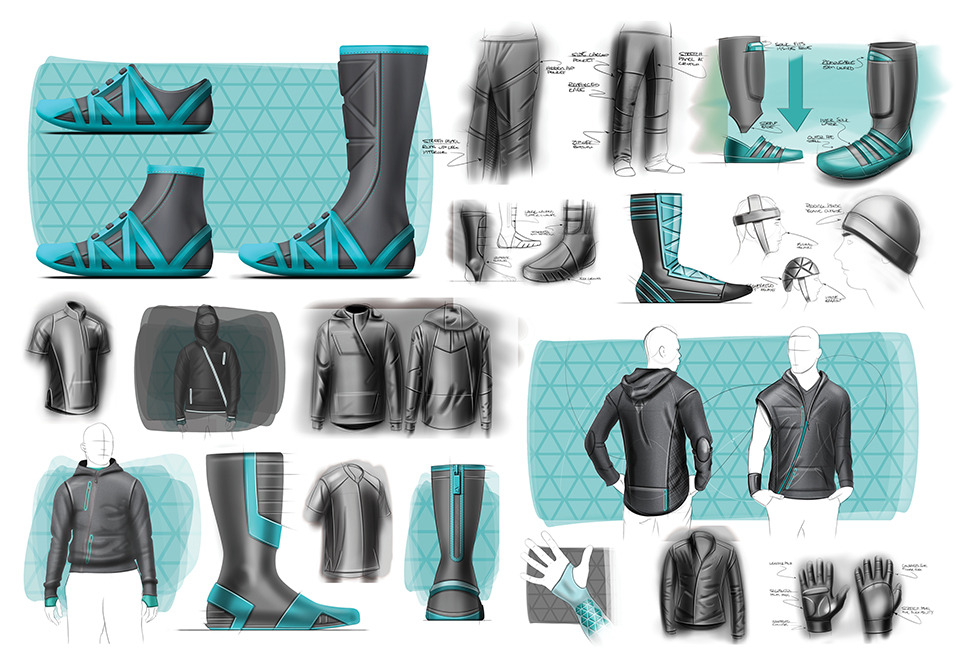

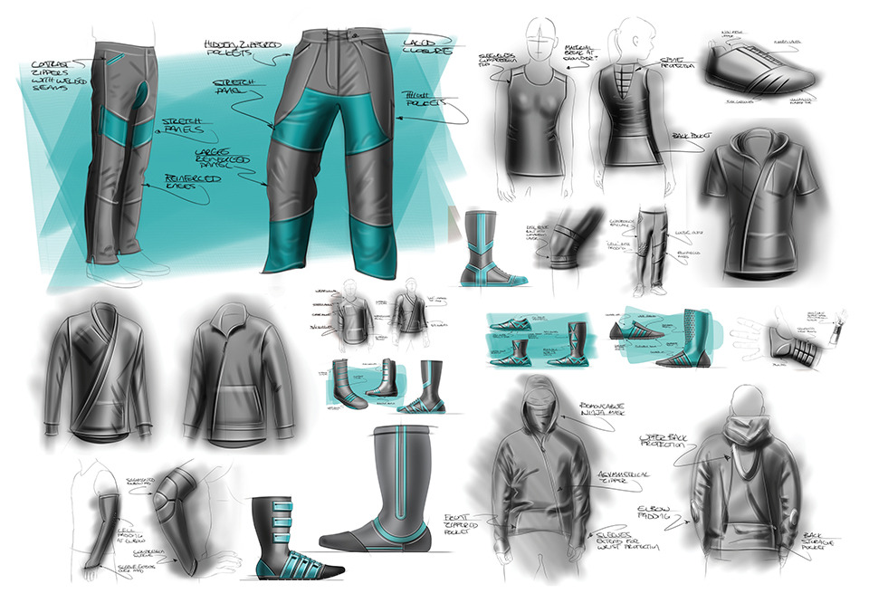

On both projects however, esp. the shoes, I wish I saw more intermediary process. I see one or two sketches then final renders. More problem solving and iteration would be nice. This is only something I noticed on the second or third look, mind you.

Richard, do you think separating the development of each individual product would help clarify the process? The path from initial concept to final project was much less linear than I'm used to. Product design was just one element of the project and in many cases decisions about the products were informed by the other parts of the project. For example, the decision around funding basically caused us to scrap(at least temporarily) four products, develop one further, and create two new concepts.
I definitely have alot of intermediate work from the bag project. I'll see what I have from the adi project, but it may also be a matter of better sketch presentation. I was working on both of these projects simultaneously(The bag was my 3 semester master's thesis and the adidas project was a one semester project), and because of the scope of the adi project, I'm not sure I have as much developmental work as I would like.

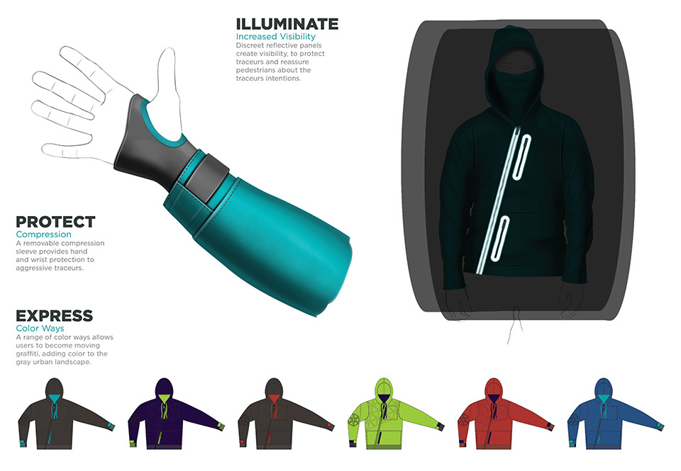

Hey Guys,

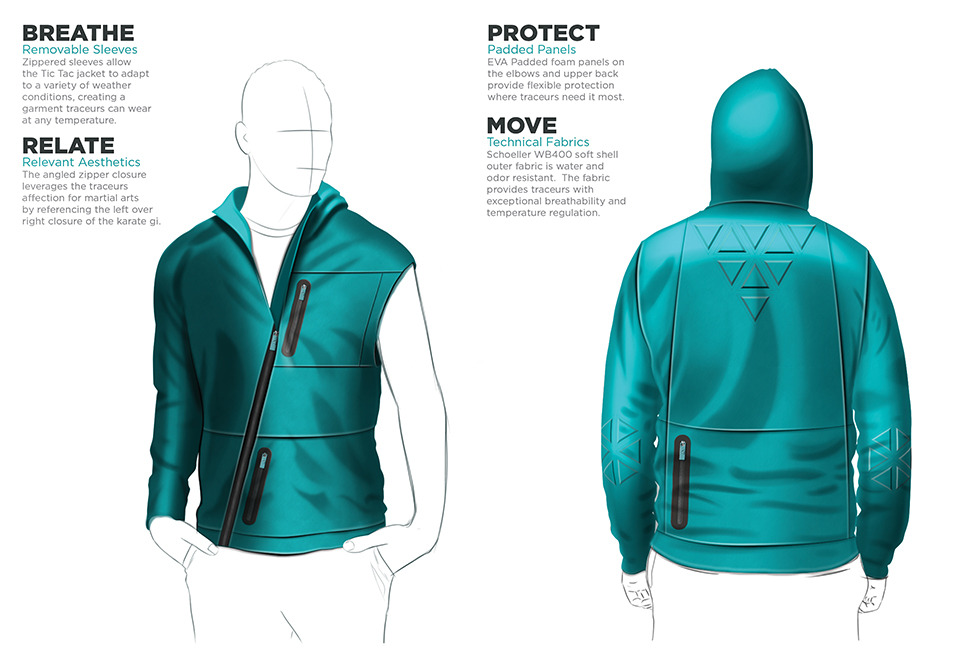

I got the chance to begin implementing the suggestions you made. I started with the adidas project and wanted to get your impressions before I moved on to the Modern Industry presentation.
I have not yet addressed Richards concern regarding the lack of intermediate process, but I wanted to get feedback on what I've completed so far.
So, is the story still understandable? Is is still too long? Too short to be clear? Thanks for your feedback in advance.
I've posted the images here, or you can check it out on my website:
http://patrickhealyid.agoodportfolio.com/adidas-vault
Strategic Targets
Brand Ecosystem
Product Ideation
Pinnacle Products
Trade Show Invitation
Trade Show Booth
Sales Catalog
Promotions Strategy
Advertising Samples

Looks good. Pretty tight.

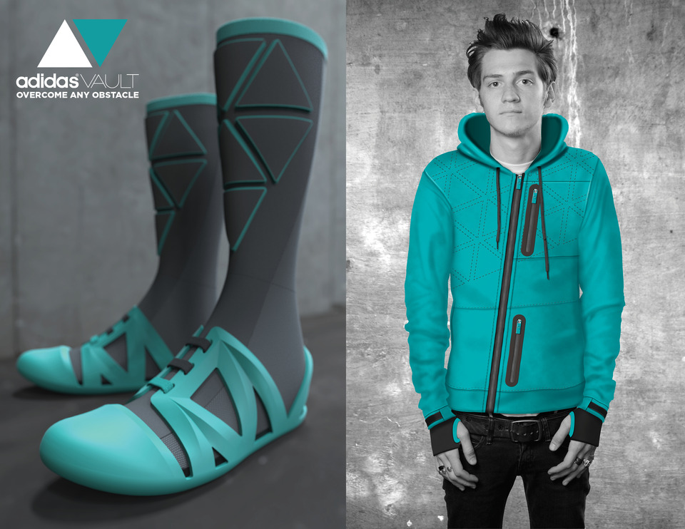

Very complete presentation. Nice job bringing a world to life. I would have liked to have seen a little deeper dive on the footwear itself in terms of fit. The cage part might have to be broken in several parts and I'm not sure all that molded material over the toe would be desirable. But, those are small points.

Thanks for the feedback. I really appreciate it. I totally agree and would have liked to dive deeper into both products to really nail down the design. I think some model building and sampling would have really helped here.
